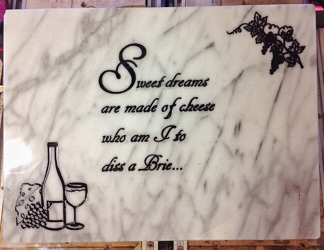

When you use the text tool in VCarve, make sure you have the “TrueType” button selected. This will then use TrueType fonts which are scalable without getting ‘jagged’ edges.
On my version, I used a font called “AR Decode” which is a cursive style font that looks nice when VCarved. See below for an example of this, however as mentioned above, the actual fonts you see are dependent upon the fonts that have been loaded onto your machine.
What did you fill the stone and seal using?
The text was filled with two-part epoxy resin with some black tint added to it.
