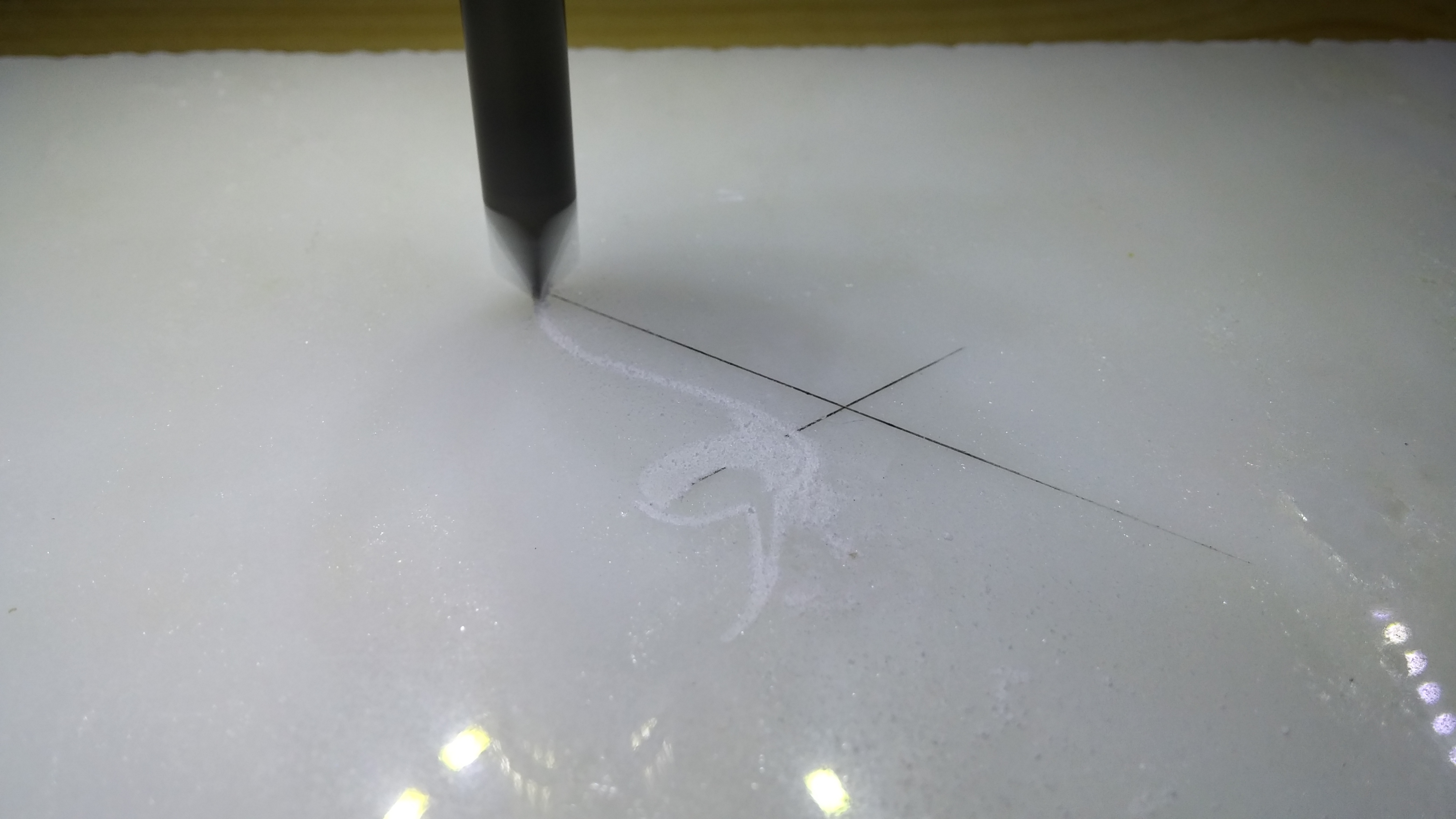

I have laid out the test design in Aspire with a V carve and an Etching toolpath. V carve for the art work and Etching for the lettering. First design is for a close friend who just lost her Great Dane of 12+ years. My first test was in Marble
Not overly happy with the font chosen but that can be changed later. Overall the design milled just fine with a polycrystalline diamond 45 degree .2mm engraving bit. These bits are not cheap by any means but the diamond tip cut through the marble like butter over all. I expected this result from my tests before with a standard carbide 30 degree .2mm engraving bit before in marble and slate.
The design needs a few tweaks and the font needs to be changed. but over all the goal was reached and the stone will engrave with ease. DOC was .1 with a feedrate of about 80mm/m to be safe on the first tests.

That looks awesome. I have some old granite pieces I was hoping to use one day. It’ll be wood for a while, but when I get to that granite, I’ll come back to this post. Do you need water involved to cut stone like this?
You should use water for a longer life of your end mill. But I did cut these dry. It worked fine but i am working on a water system now that will not flood the mill room also. I already have orders for more pet memorial so I need to get cracking I guess on the water system.

No. Carbide will be destroyed faster than you can blink. You will need a PCD engraving bit. I have ordered mine from China from the usual suspects. You will also need to pump water to your bit, because you really don’t want to breath granite dust and it also helps to extend the life of the bit. So you will need to have something else than the original MDF bed. Also make sure that the granite slab if of even thickness and if not, shim it flat. I usually use something like 0.7-1.0 mm as a total depth and paint engraved areas white. I have some photos of the stones I have engraved on my Instagram: https://www.instagram.com/jyrkipa/
