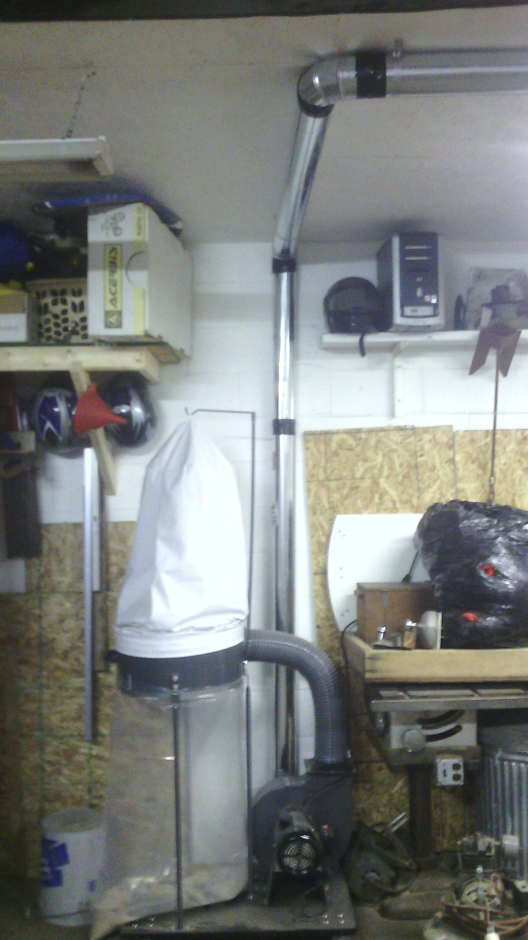

Yes. I have the Powertec 1 micron from Amazon. I noticed no decrease in overall flow. It is slightly larger in diameter than the Harbor Freight bag and is difficult to secure with the stock clamp. A belt would probably work better. Also, the dust collector tends to backfeed during shutdown. Beware of sensitive electronics on the same circuit. It already blew a bridge rectifier in one of the pinball machines in the house requiring extensive soldering repair.
