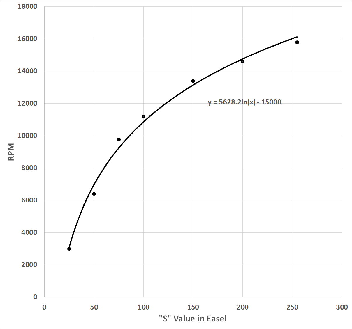

I’ve upgraded my X-Carve with the JTech laser and their GRBL firmware. That meant that the “S” value settings are in the range of 0-255 instead of actual RPM. With the help of a laser RPM meter I was able to correlate “S” values (e.g. M03 S100) to actual RPM of the spindle. The resulting graph along with regression equation is below:
The graph can be used to pick an “S” value for any RPM desired. For those into math, the regression equation can be used to get an exact setting.
