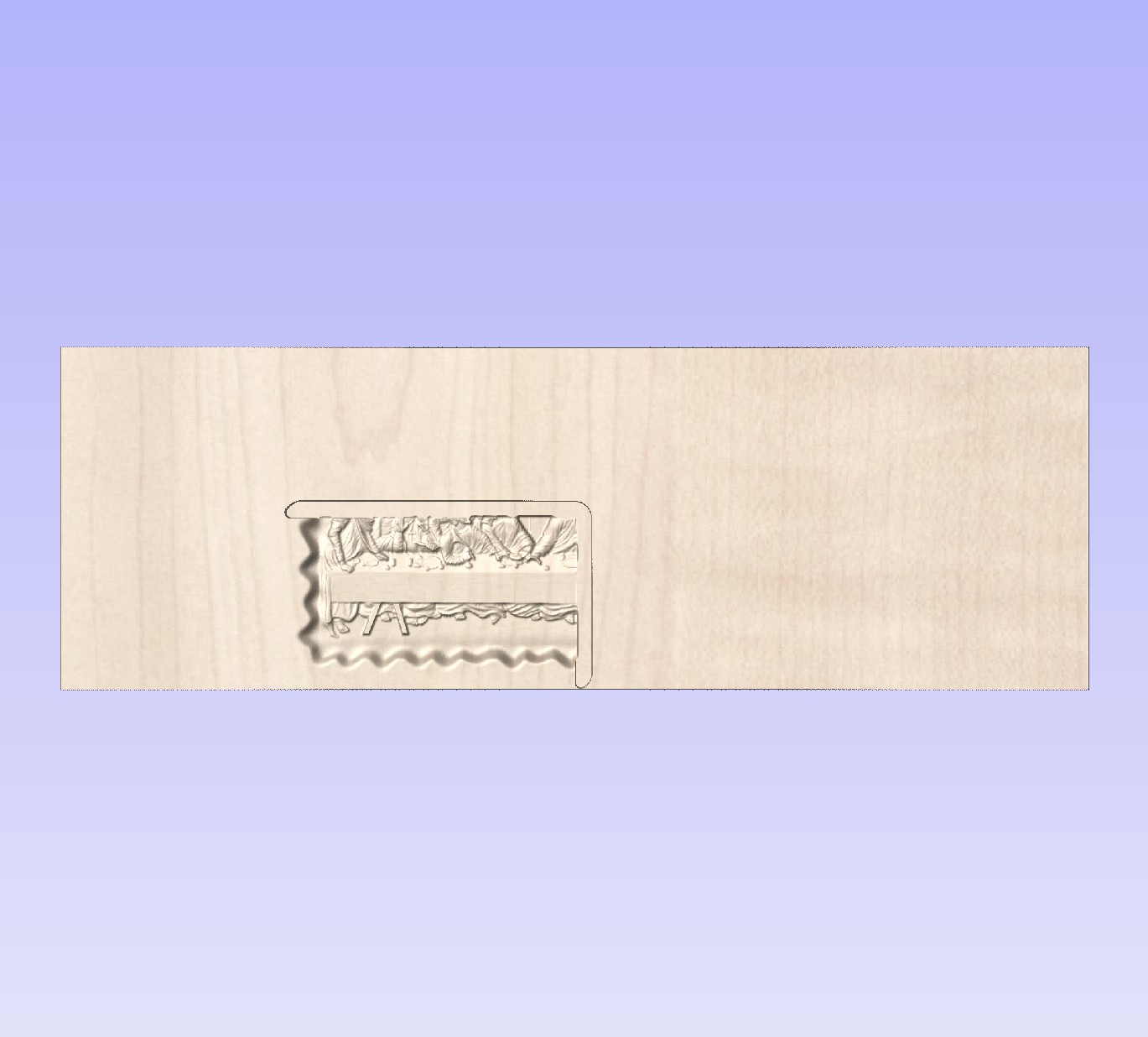

I just bought the Last Supper model style C (File: LastSupper_58060_C.stl) from Design and Make. Imported into VCarve, set the rough and finish toolpaths. And even though in 2D view the whole 3D component is centered and selected. When I create the toolpaths I only get toolpaths for the left corner. See picture
My Dad got his churches old doors after a recent replacement. 100 year old Oak, which we cut the door into the orginal chunks. We are taking the bigger pieces and trying to carve the last supper in them to give to the church. The one side is rustic stain and worn, I cannot wait to see the carving in the wood. Murphy’s law always gets me everytime I try to do a project with my Dad, who taught me all my woodworking.
Although, from experience, I know it’s something I’m doing wrong in VCarve. Any pointers?

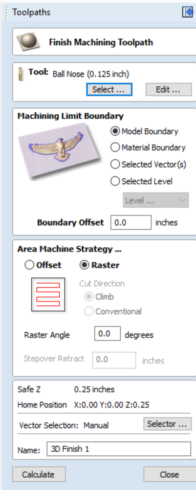

Post your 3D toolpath settings?
I’ve found that if I set the XY Datum to center I can get toolpaths. That only took me a hour or two… LOL.
I typically zero on the lower left corner.
Resolved - although I don’t know what the solution was.
After setting the XY Datum to center I was able to generate toolpaths which were centered on the workspace. Then I change the XY Datum to lower left corner and it functioned as it was suppose to. Dang that was a lot of time messing in Vcarve when I could have been carving… Lest I’m working with the component now.
