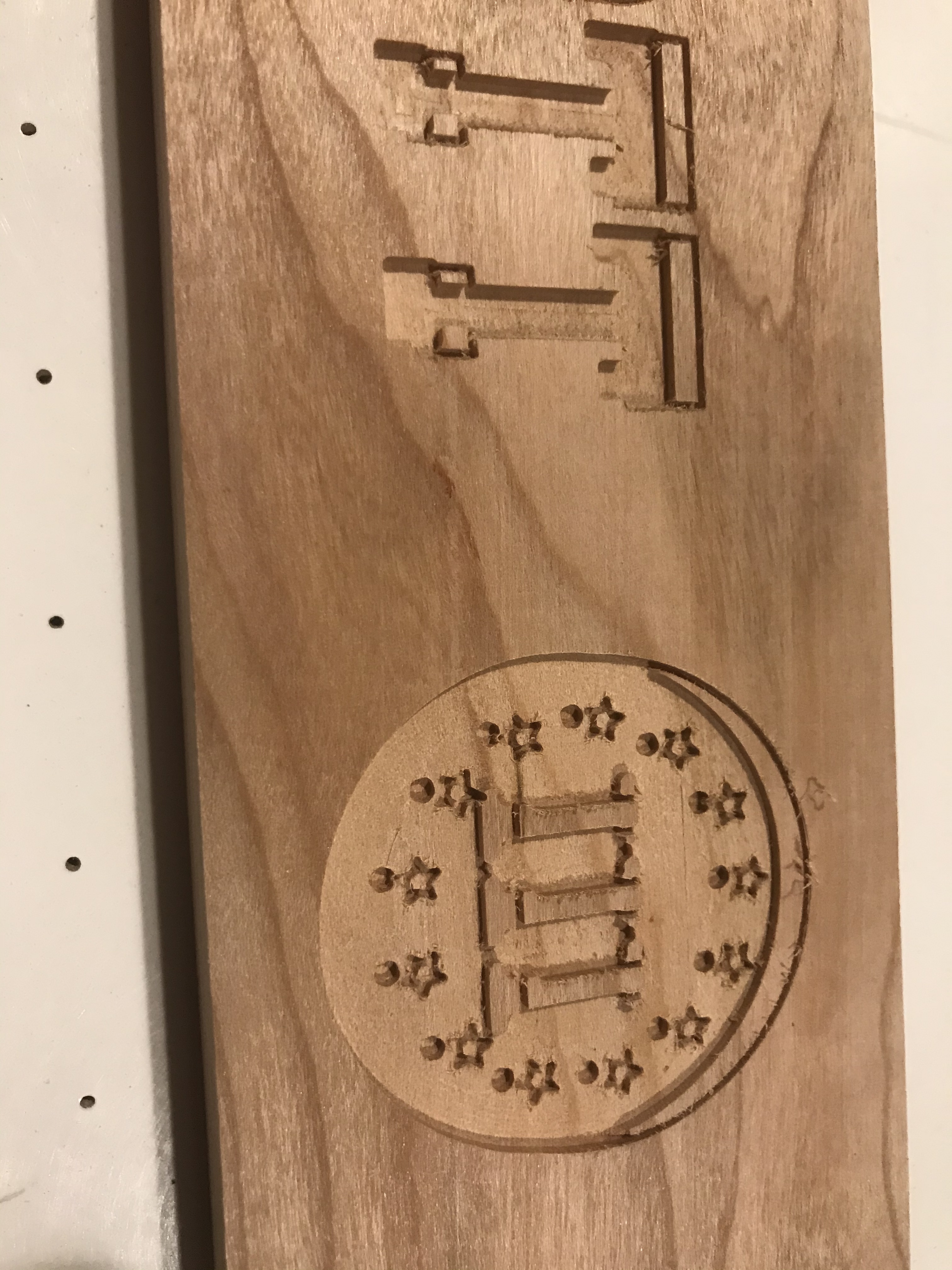

I have no clue what happened here. This is my first time using the two stage carve feature. Normally I just do separate carves when I have different bits on a piece, but I was excited to see how much time it would save if I let easel calculate what the hogging out but could take before the detail bit.
Well it didn’t work. I homed the machine after changing bits which I always do. I re-used my prior x y zero which I always do. The piece is on my x and y axis fence and is secured and didn’t move.
This carve was the first time I saw the lock motor option under the keyboard control button. I assume this is to make sure the motors are locked while you change bits. But I Home after changing bits anyway so this is a mute point right?
I’d appreciate any help. Belts are equally tensioned.

Also make sure your GRBL parameter $1=255

This might help you
$1=x where x = the time in milliseconds of idle status before reduced current function is enabled.
$1=255 => which is the highest value allowed = never idle, which is what you want.
Awesome this fixed it. Carriage must have shifted during bit change. Which I still don’t understand because I homed after bit change.

I suspect your machine lost some steps prior to the tool change - or soon after. Hence when re-aligning machine with design (homing switches) still came out misaligned relative to what was previously carved.
