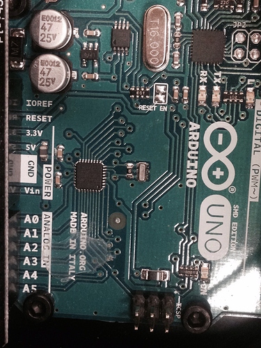

Ok, out of no where my machine just decided to not work. While check wires I touched this black box on my arduino and holy f, this thing was hot, real hot.
Is this normal, are there other things that can be wrong?

The black box that is referred to, is that the enclosure from Inventables that attaches to the power supply? If so, itās probably acting like a heat sink from the heat from the power supply and transferring it to the board.
I think by black box he is referring to the chip he has pictured. If I am not mistaken that appears to be an SMD version and that chip is the Atmega328P microcontroller.
ICās getting really really hot usually mean one thing - short circuit.
Iād get a new Uno and test (or get someone else to check theirs)
I wouldnt expect that IC to become very hot during normal use.
(warm, maybe but not hot)

What is the Arduino mounted to? There are 2 screws showing it is mounted to something. Is it possible that it is sinking heat from another source?
Your best bet is to replace the Uno because youāre probably dealing with a bad board. You can try some tests to see if its the board or the I/O wiring. Let it sit idle (not running Gcode) and see if the temp goes up. Then you can remove everything from the I/O pins and let it sit idle and see if the temp goes up. A temp measuring device would be ideal for this (infared/laser temp sensor) and there is an internal sensor you can look at:

its odd because 30 mins later it was all good.
So I think Iāll just spend the few dollars and replace the arduino.
Nothing would be worst than ruining a piece of expensive stock for a $5 Arduino.

The ATmega328p processor of the Arduino UNO has a power consumption of 18mA at 5V. The output pins have a 40mA limit, any higher will destroy the output. It is not normal for the processor to get very hot.
I have had $5 boards that got very hot, A genuine UNO only costs $30 and is fully factory tested, the Sparkfun Redboard $20.
If the āboxā (akaā¦ Atmega328P chip) is getting that hot you may have a bad Arduino Uno.
From the looks of your picture, iād assume its a āfakeā Uno (real Unoās donāt have āarduino.org made in italyā printed there). Which is (IMHO) fineā¦ im a big fan of buying clone Arduinoās.
However, from my experience, the clones that are trying to look like ACTUAL Arduino are the ones that fail the most. Even the $5 ones from china have stopped trying to copy the real $25 boards.
I would suggest picking up a new Arduino and see if the problem goes awayā¦ The chip shouldnāt get that hot.

My guess as to what the problem is something in the chip has shorted(It happens silicon can break down)
So I think there it was an issue with the amount of steps I had set for the z axis. Some how I had this set to 188 step/mm this may have been causing wayyyyyyyy to much info to be set through arduino.
