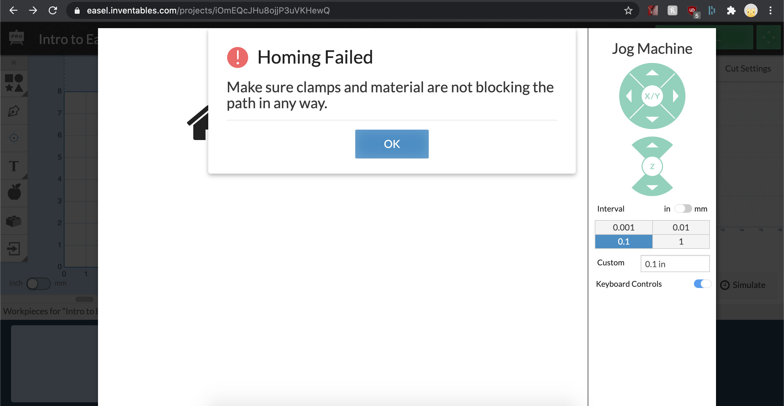

Homing Sequence buzzes/stuck after
The homing switches all work. I have used the Machine inspector to verify this.
I have tried to use the contacts, and manually pressing the contacting during homing.
When homing, it works perfectly fine, but then after all the contacts touch, it creates a buzzing noise, then I get the following message:
What’s your $27 value?
Try increasing it.
