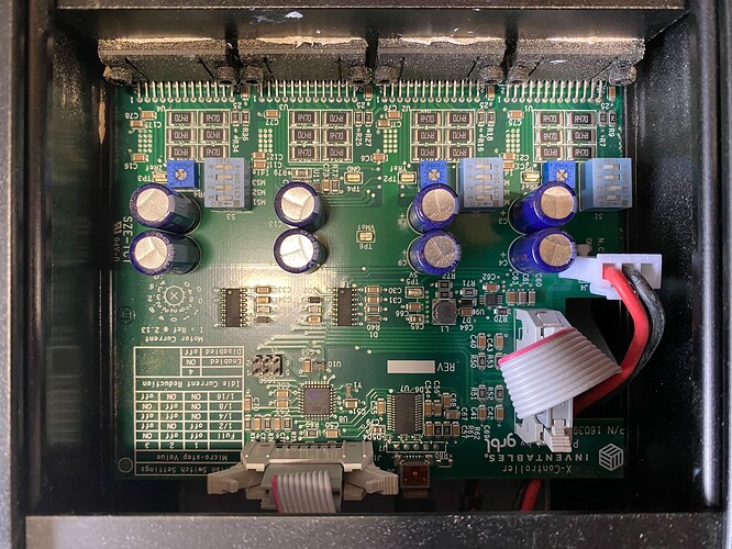

Did all of this! I even tested with the other Axis, the switch is working. It HAS to be a problem inside the main controller, on the other board,
Including Circuit Board Photos.
not sure if this is off from having to take it apart for the photos, BUT this cable is what connects the green plug (for X,Y,Z limit switch) up to the controller board on the top… making sure its plugged in fully and snapped in place is just about all that can be done other than replacing things like the main board, or the cable itself…

So I think I’ve traced it back to either the green connector to the back of the x controller or the electronic board it connects to. The latter would not be ideal! Hopefully it isn’t a bug with the latest batch of x carves.
I took it all apart and reconnected. It was a pain, but it worked As SethCNC said, that ribbon cable could have been the problem.
Great! Glad you got it solved. Mine was much the same solution.
I had taken apart the controller and reseated each of the gray ribbon cables and it didn’t fix it. But an Inventables tech suggested I swap them and see what happens and it worked! Not sure why, but its fixed now.
