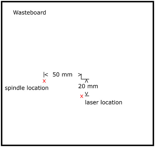

How do I match carve zero & laser zero
Any suggestions on how to find zero with the laser after the piece is carve so it can be etched?
If you’re Vcarve user it is easy. You can make two copies of the drawing, one for carving other one is for etching. You must know precise offset between laser point and bit point. Laser etching drawing material seting must have same offset.
I’m assuming that you are using the multi-mode grbl that I posted. If you have not upgraded to the 10/12/2016 version you should do so.
What programs do you use to create your carving file and laser file? and what program do you use to send the G-code?
Yes I am using the multi mode you made (thanks). I am using vcarve to create and UGS to send the code.
As Alan said you can determine the offset of your laser from the spindle and use that offset in Vcarve to place the laser work relative to the X and Y zero of the carving. Don’t forget that you need to move the laser to the appropriate Z distance that you used to focus the beam.
I might have to think about this some more. I think once the procedure is established it shouldn’t be too difficult.
@DavidSpencer
In order to carve and laser engrave on the same work piece it would be helpful to setup your machine so that both the spindle and the laser can be positioned over your work zero location.
First you would need to measure the offset of the laser with regards to the spindle as illustrated below. In this example I have assumed a 50mm offset in X and a 20mm offset in Y.
Then to set up your machine so that either device can reach work zero you would position your work piece as shown in the following example, once again assuming a 50mm offset in X and a 20mm offset in Y. In this example when your laser is at work zero of the work piece, your spindle would be at the left side of the wasteboard 20mm above the front edge.
At this point there are many ways to set up your design so that you can switch from carving to laser work without having to reset X and Y of work zero.
You have the option of placing your design components in Vcarve such that they will line up as you wish when you carve and then follow up with the laser.
There are also ways that you can change the work position in grbl to offset a design.
It just depends on how much flexibility you want to design in, in regards to reusing your designs from project to project.
