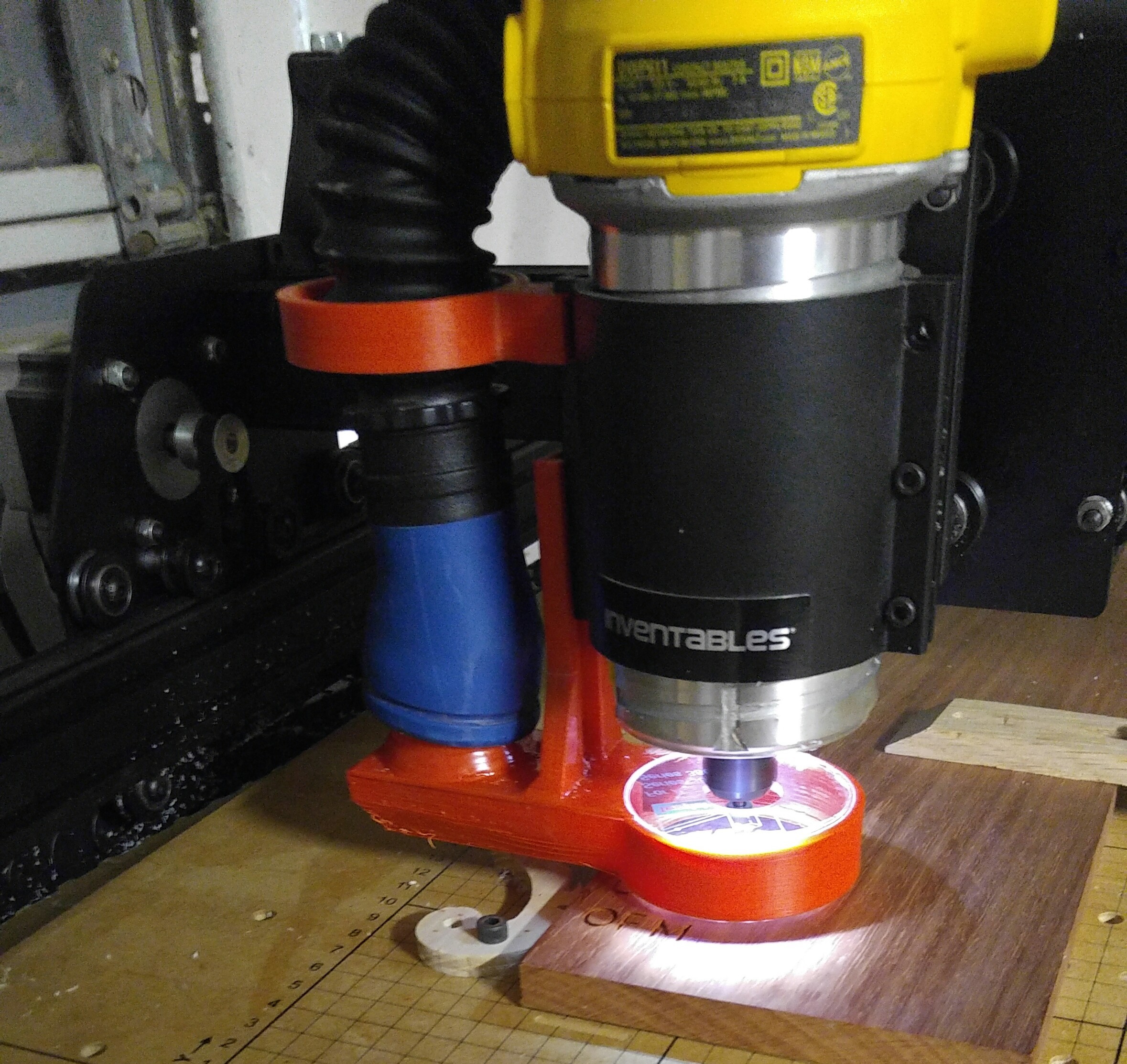

I wanted to roll my own vs. buying, and have a 3D printer so took the challenge as practice designing. NOT an ME by trade. Goals I was after was a) mating up to existing Rockler ‘small tool’ dust hose, which I have routing to a larger diameter hose fitting against the wall behind the machine to my 2HP dust collector for my cabinet saw, b) wanted it off the side of the mount since I thought all the big ones looked like they weighted the Z-axis ‘down’ in front too much (potentially tilting the bit in the YZ plane…I’ve done nothing to improve rigidity of my X rails yet), and c) I was trying for something I didn’t have to remove to change bits, could just loosen and slide down a tad, and then retighten. It’s also more of a ‘fixed’ dust catcher design intended to set at a clearance height above the bit tip vs. having plastic wipes or brushes.
So, the ugly truth:
The top ring is fixed and just there for extra stress relief to the hose fitting in the part below, it screws right into the threaded hole in the router mount and never has to be altered. The bottom assembly has that vertical shaft and similarly pinches to the router mount with a 4mm screw. If I remove the hose I’ve got a split in the round mount for the hose so I can access that hardware easily to loosen and slide down out of the way, to change bits (the router lock button is not blocked) , then return to the desired height and push the hose back on. The shoe itself is printed as 2 pieces, a bottom that’s kind of boat-shaped with the circular bottom aperture, and a lid with the vertical shaft and hose attach point, then I just cut the clear cover out of a piece of waste plastic I had laying around from something else (hence the writing barely visible on it.)
As far as dust catching it actually does really well - even milling foam which as you can imagine is a static-ridden mess, I get no dust. It’s also super lightweight and the expandable hose tension probably has more impact on the actual movement resistance than the shoe does. But it has some definite flaws. Being off to the side, it restricts my travel to the left (but it’s sneaky…if I do ‘homing’ the machine homes Z first so this raises above the rail in most cases…and then crashes into it if I try to drop Z before remembering to scoot over in X for clearance. D’oh! Probably currently costs me 2 - 2.5" usable X axis distance at minimum)
The vertical mount part is also printed totally the wrong way - I should split this off as a separate part and print that flat to the 3D printer so it doesn’t split so easily between layers. It look obscenely glossy in the image because I coated the whole thing with epoxy for a little more strength and it’s still fractured (thanks to hitting the rail of course).
Works for now but preparing another go-around at a unique design. Will likely try to mount to both sides of the router mount as everyone else is doing to center it and get more strength, also so I don’t cost myself X travel. Maybe split the airflow up both sides of the router to one hose fitting pointing backward at the top to keep it all in the front facial ‘footprint’ of the X carriage if I can. Also like that this doesn’t extend below the bit at all so the only cost in Z travel is currently that I didn’t cut the hole in my plastic cover big enough for the collet, although of course the higher this gets relative to the tip the less dust gets taken.
So far I"m out about $0.95 worth of ABS filament, a little electricity, and $2 of epoxy (the 4mm hardware is reusable), plus a fair amount of design time and mental humiliation, so I’m not beating myself up TOO badly. But yeah, not a winner.
Laughter welcome.

That’s not at all what I was expecting. The way you talked about it I was expecting a MONSTER lol. Actually it a no nonsense practical design. You mount yours the way I mounted mine. Screwed right to the spindle mount. I came off the mount with a straight bracket to the side of my boot so it comes off the front. The only problem with that. When I cut deeper 3D contours it will bottom out on the work piece.
I’m currently in the process of some “heavy” mods and plan to have a new dust boot mounted directly to the X carriage That way the Router can move independently.

Make sure you crack some of the fittings in the system. a 4" 2hp duct collector wants to move much more air than the Rockler hose can. The fan stalls in the DC, and so you loose throughput. If you partially open a wastegate in the system, the fan is moving the correct amount of air, and the smaller hose works better. Sounds counter intuitive, but it works.
@CurtisCummings you’re welcome. I do like the idea of mounting off the X carriage so it doesn’t move up and down with the router. Trade off less dust absorption the lower the router is working for not mucking up your workpiece or catching and making you miss steps. Potatoe, Potahto.
@Andy4us, thanks for that. I do have a Y adaptor at the impeller with a cap end on it, might just go ahead and hook the other 4" hose to the cabinet saw instead of capping the 2nd Y path…since that’s drawing inside a closed base thru the saw slot, might provide just enough ‘bleed’. But suction already seems pretty good (good enough that when I got overly aggressive on making tabs small on cutouts I was having to pause the work to turn off both router and impeller to rescue the cutout and the job).
