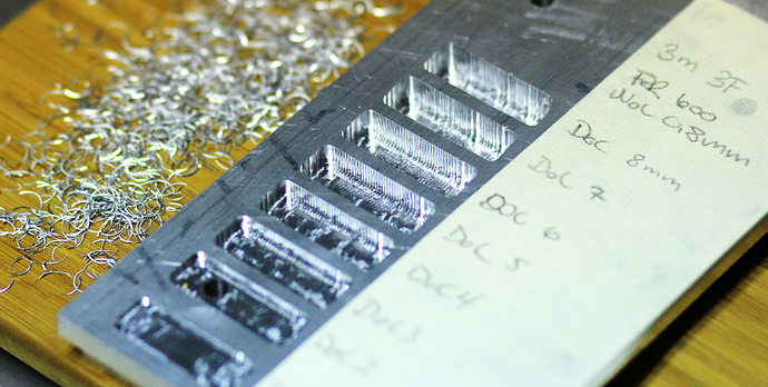

Here is an example I did on my DIY CNC (Not Xcarve) with same pocket, same cutting parameters but increasing DoC using 2D Adaptive. It coped well down to 4mm, anything deeper it started to deflect.
Halair_CNC_DoC_test
Very interesting, thanks. My feedrate and DoC was based on trial and error (a lot of error), so good to see I’m not a million miles away from the calculated value.
