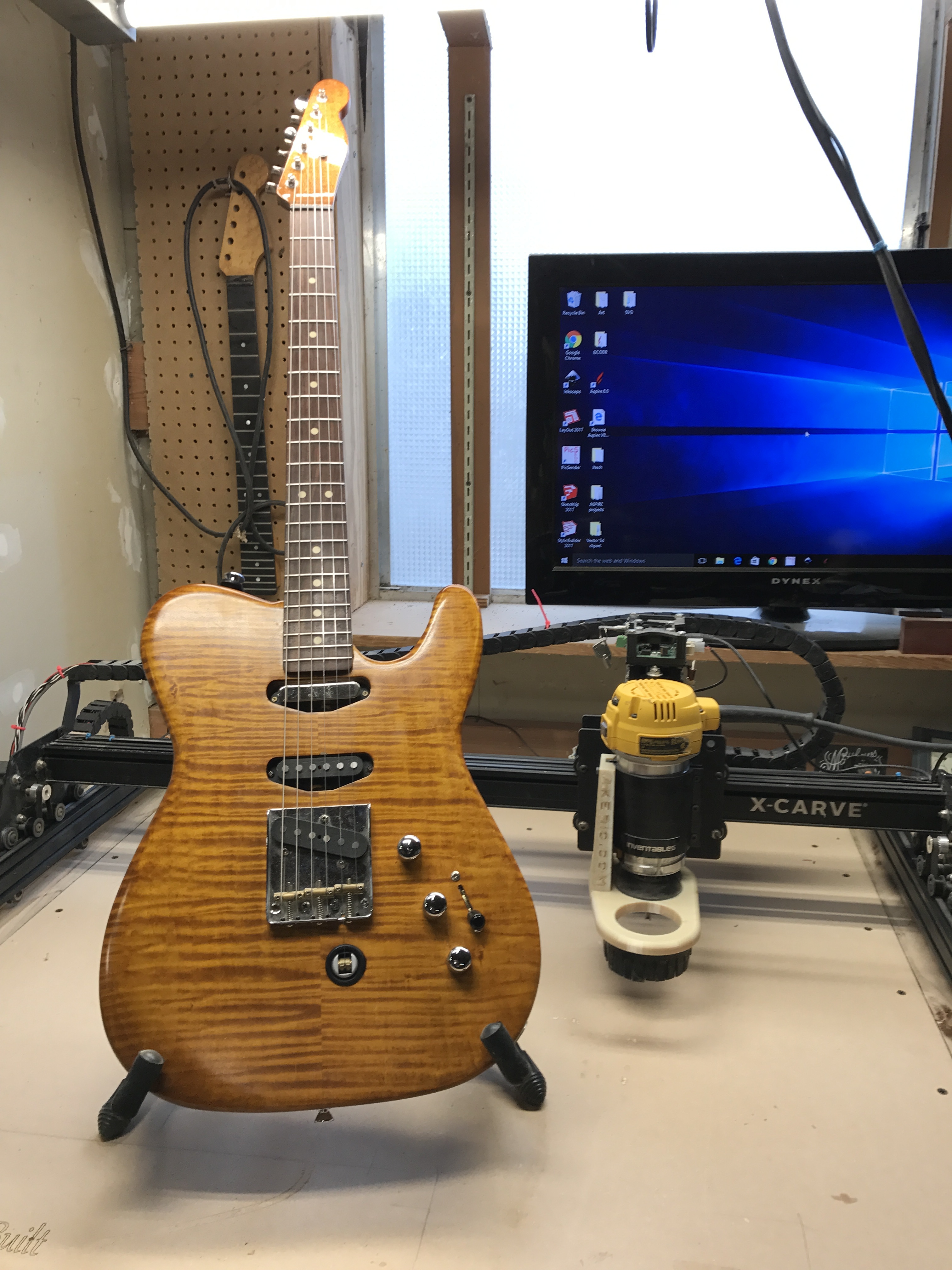

Here are a couple I am working on currently and my first B-bender Tele. Love my XC!
What kind of wood is that @Bill_LeachI love that grain pattern.
That is flame maple, I use that quite a bit, quilted maple too
Do the different woods sound different when the guitar is played?
It would if the guitar was a solid piece of maple or alder, mohogany ect. But this one has a 1/4” maple top with a cherry back and i feel the combination make a specific tone if you will, and then other players would say you have to have ears of a dog to tell the difference. It’s a pretty interesting discussion
