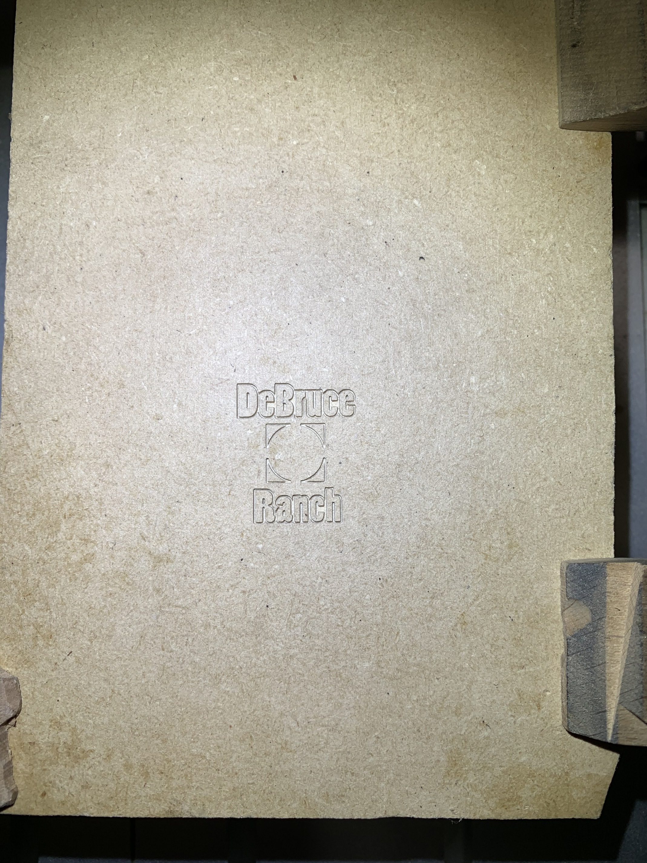

Just finished the final settings and calibration
Here are the results:
