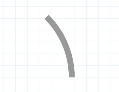

I am building a train layout and I need to cut out whats called a radius gauge of the many different radius I need.
(For Example) The short description is I need to cut a 15 inch (on center) arch which is 1/2 inch wide and 45 degree’s. I can draw the 15 inch radius circle and get a 1/2 wide strip.
What I can not do is figure out how to only cut a 45 degree portion of the circle.
Something like this…? That might not be the correct size, but it shows how to do it.
The shapes have not been combine so that you can see what was done, but if that is what you want then just select all of the shapes and combine them. You would then only be left with the arch. You can then change it to an outline if that is what you want.

I updated the example to be 45-degrees. Playing with shapes in Easel is one of the easiest things to do to make other, more complicated shapes. Just keep working at it and you will eventually get what you need.
If you still have problems, I might be able to discuss it with you one-on-one if you need.
I had to cut 12 circles at full depth, and then cover the portions of the circles with shapes with a zero cut depth to end up the current piece.
Also had to make sure that the inside cut of a larger circle didnt cross into the outside cut of the smaller circle. With a 1/8in bit, I was able to make 1/2 inch wide pieces with 1 inch radius differences.
