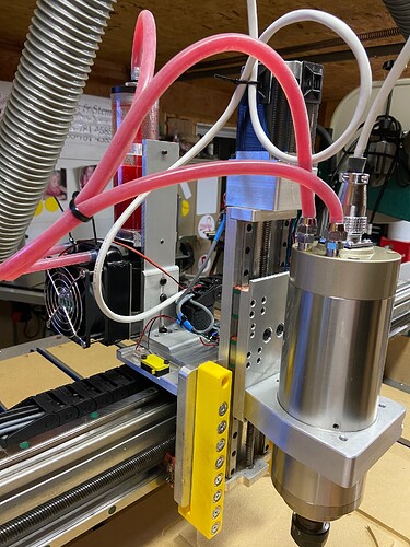

My spindle, 12 volt inverter and pump. Some people go with a pump and run it into a 5 gallon bucket, I didn’t want to run hoses through the drag chain so I attached the pump, radiator, fan and cooling fluid reservoir to my X axis .
Wow awesome 3D project! I have done hundreds of two d but not 3 with my x carve yet.
I found a nice kit on here from someone normal looking in Florida.
I’m not too sure I can pull off mounting all on my x axis. I will have to run a bucket.

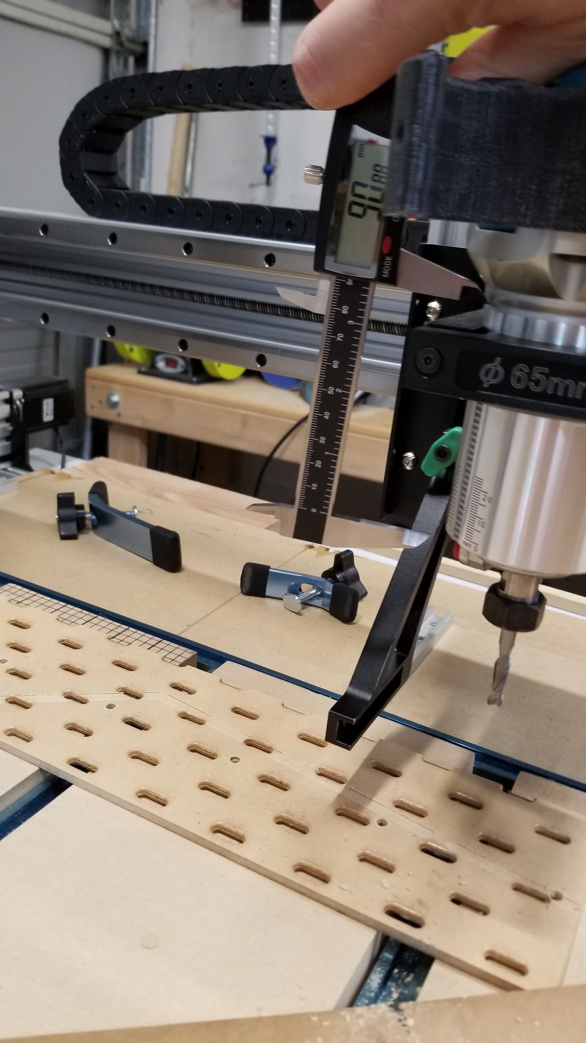

I got an X Carve about two years ago, wanting to do some arcade control panels I realized the bed was small, but made a TON of cool stuff and with tiling was able to pull off what I wanted, but I wanted a bigger machine to load a 4x4 sheet and rock n roll. So I went ahead and bought a Queenbee1515, and I too was on the fence over which router or spindle I wanted, (my boss at work liked the idea of having a cnc here at the shop so he bought one and I got to build 2!) and on both we had the choice to make, and decided on the Makita router. Compared to the dewalt router i was used to with the X Carve, the Makita had a different spectrum of control, think of your dewalt if it had a -3 on the dial. I’ve cut sheet aluminum, coroplast board (coroboard) 4mil and 10mil thick, clear acrylic, and the ability to dial the Makita down low was a big help.
We thought about a Spindle but for what it is and the cost of the actual machine and what I wanted to do with it made the Makita the perfect choice for me.
The spindles I was looking at ended up being too heavy for my liking, especially for the X carve even post upgrade, and I personally felt like the whole coolant thing would have gotten more in the way than I’d have had the patience for.
So do you run the makita on your xcarve ? And if so, any mods to put it in the current mount ? How is the sound compared to dewalt ?
No I still run the dewalt on my X Carve, because I only bought the one for the Queenbee.
The Makita is quieter in my opinion but I cut MDF at 90ipm with a 1/4" bit and it does make some killer cutting noises…(note the Makita is on my Queenbee).
As far as adding it to the X Carve, the makita is thinner (65mm) than the Dewalt, so you’ll need a shim. (3D Printed? Petg?)
Adding a pic of my Makita mounted, bought another vac system from Inventables and modified it work independently like on my X Carve, really like how it stays stationary. They sell those router mounting brackets on amazon, taking measurements now for you to see if it will be able to maybe fit over on my x carve… easiest way is with a shim spacer. The bracket I have would fit on the x carve upgraded z plate but you’d have to get a smidge creative, not too bad though. Cool thing about the bracket is they sell a round LED light that goes under it too lol.
