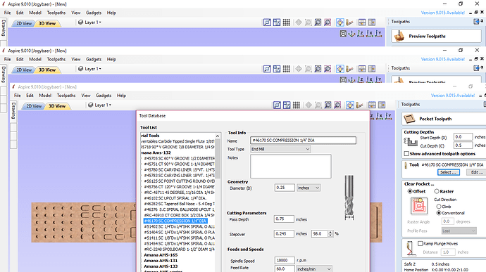

Homes correctly, probes good, set X,Y, Carve! The Z axis raises and doesn’t stop when it makes contact with the limit switch, the hard stop fights with the carriage for a few seconds, and then begins to cut, and plunges straight through the material…Please help. I already swapped switches, its only the Z doing it, not a particular switch.

So i just ran another carve, these are all G codes from Aspire. The new carve worked perfectly, so I went back to the old one I was having problems with, and of course, plunged through the work. As I look at the toolpath on Easel, its doing exactly what the machine is doing, all the was down to the wasteboard. However in Aspire, my max depth for those cuts are .5 on a 1.5" thick piece of wood. Im going to start over and recreate the file from scratch, something is off.
So I’m seeing max depth of 0.75" on first glance. How thick was your stock?

A guess:
You had a start Z of 2". Depending on your setup, you may have crashed the Z on that lift. When that happens, the machine can’t retract as high as it “thinks” it did. Where the controller thinks you’re at 2", you’re actually at 1.5" because of the lost position. When you plunge to .75" (are you cutting foam?) it actually ends up at 1.25" deep.
Check that initial Z height.
That 0.5" looks better. Make sure you preview the cut. Easel will show you what it’s going to do or you can use something like this if you move on from Easel.
