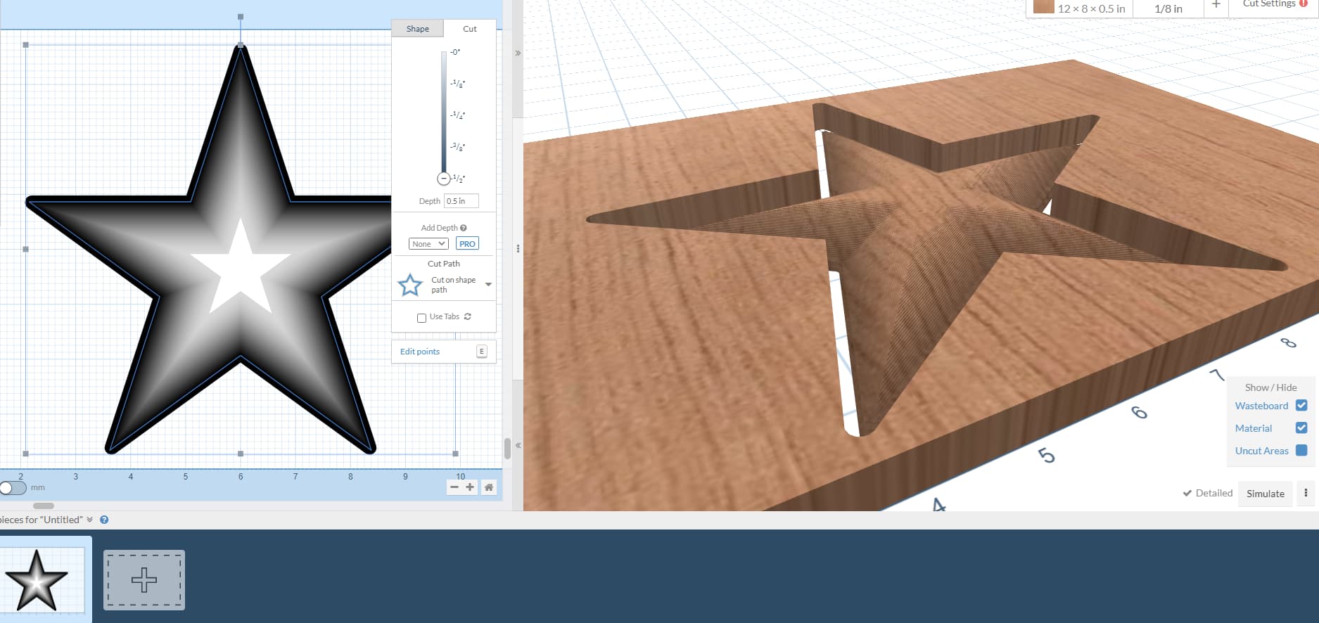

Problem importing SVG from Illustrator into Easel. See photos. Any clues?
it looks as though the layers are out of order. You could go through and re-apply the order of the layers within Easel by using the “move to back” or “move to front” functions OR you can use the star perimeter and the App called “Super Gradient Generator” over in the Lego button on the left column, and you can end up with something like this, with the appropriate settings… .
Thanks Seth this is a big help! Just started using Easel a couple days ago and trying to find my way around.
