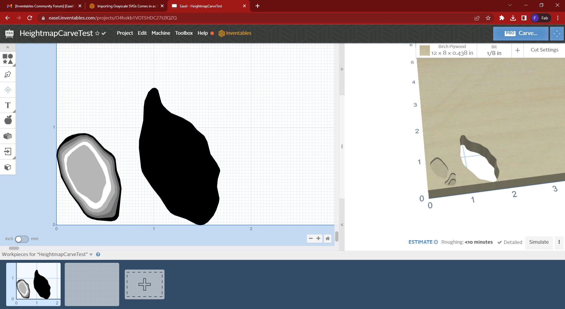

This is a large and time consuming project, so Manually changing the colors, while time consuming, is necessary, but I can’t work with it in Easel. It would be too much manual labor to do it all in there. Ideally I can make this all happen in an inkscape file, and import it to toolpath it in easel when i am happy with it.
I did the “Break-Apart” → into “Union” so that there are no holes, but it still doesn’t seem to want to import the color. The SVG opens into a web browser with color just fine.

I think I understand your issue. I’m not sure what @Robert10 is getting at, so maybe I’m confused.
This is what you’re going for, right?
If so, can I guess that you originally started with a non-inkscape SVG?
Easel should set each shade of grey to a different depth. @Robert10 Try your example again without the gradient fill…use a different shade of grey for each segment.
Yes, the Topographical map was originally not an inkscape file. I am copying the rings over, and coloring them by hand to have them match the exact grayscale I want, then exporting from this new document.
I’m not getting the result you are however… What did you do to make that work?

I had to modify the SVG output with a text editor. I can send you what I did later when I’m at a PC.

I copied the Rings over from the SVG that is in the heightmap in the top image, into a brand new inkscape document. I then manually set the fill for each of them in this document, and then used “Export”.

Sorry for getting to this so late. I figured you weren’t waiting on me, so I explored this a bit more.
It looks to me like the SVG style property “fill-opacity” is causing the problem. This is not an issue with the SVG as far as I can tell, and I’m not sure I’ve seen this issue here before.
Two ways I think you can work around this for now. The first is what I did to create the screenshot above. In a text editor ( I like Notepad++ or Sublime, but Notepad should work just fine), do a find and replace (Ctrl+H on most Windows programs) and replace fill-opacity:1; with nothing. Then save. This will effectively remove the property from the SVG, and Easel will load it correctly.
The second way is to save the SVG as an “Optimized SVG”. This will remove the unneccessary property and load into Easel. My Inkscape settings, and version, are different from yours, so this may have different results for you. The text editor method worked with your file without ever opening it in Inkscape.
Anyway, here’s the modified file: path10080_FIXED.svg

Edit: Further digging. If I individually select the layers and click “color fill” from “swatch fill”, it keeps the color but fixes the issue. so swatches are stored differently I guess.
Thanks for digging!! It at least sets me on the right path, and I hope this thread helps others.
Yup, using swatches was the only way I could replicate the issue. But once you click on swatches, there’s no going back.
