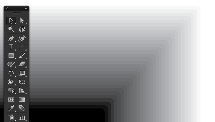

I am having problems importing svg from illustrator to Easel.
Is there a limit to the shades of gray? Iam trying to import 32 different shades, that is not much.
Please take a look at the images.
Illustrator:
Easel

@Zach_Kaplan
I read in another post that Easel supports 256 shades of Grey
So I created 256 squares with 256 shades of grey
Check out what happens when you import to Easel.
If this works it would be very useful to create smooth transitions
Is there a workaround?
Thanks in advanced

SVG 1.1 imports the color, SVG 1 does not
I am using the Blend Tool in illustrator.
But this looks like a bug, because even if I import a few layers / shades it has the same problem.
I attached the svg.

@Zach_Kaplan these links don’t exactly cover the problem I am describing. For some reason Easel is changing the colors of the svg. I have much less that 256 shades of grey, actually less than 30, and the shapes are pretty simple.
Please try importing the file I attached previously to see the problem.
Thanks in advanced
I suspect that the issue is the number of layers, not colours. I create SVG’s with multiple shades of grey and import. I did a test one, 256 shades of grey in 0.1" rectangles.
It imports fine. When I import your’s, it basically locks up Easel and I have to delete the project !
