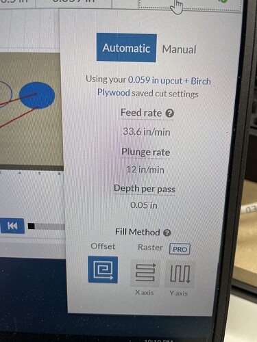

Okay so it looks pretty in consistent in terms of measured gap. On the “y” is .011. On the “n” .025. It’s a sizable gap for an inlay. I double checked my but measurement and it’s tight at .059, which is the setting in my file on easel.
![image|375x500](upload://
j7VMPI9H2ttHY0OJtNj1qsG2HMU.jpeg)
Ugh. :man_facepalming:t2: Inlay app vs pocket and outline cut
