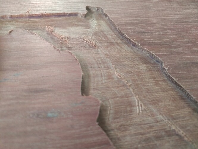

So I’m sure I’ve got some setting incorrect here. I’m prepping an inlay board on purpleheart, using Walnut as the material type. Using all default settings in Easel. As you can see in the pictures, it doesn’t seem to be cleaning all the portions of the inlay carve. Granted, it is simple enough for me to use a chisel and clean it up myself, but curious to know what I am doing wrong. I’ve had this make clean cuts in other materials.

Are you using dust collection? If so, make sure all your V wheels are good. Then ensure that your dust collection bristles are barely touching the surface of the wood, if not a bit above it. The bristles are stiff enough that when the carving changes direction it ends up raising the whole Z axis up.

Can be due to router not being fully in tram relative to the material, and/or a bit that is turning dull tearing wood fibers instead of cutting them cleanly. Some woods are more tricky than others in the department.

For wood and “large” diameter bits like 1/8" there is rarely need to go faster than the minimum RPM of the Dewalt.
If your chip thickness (thickness of each shaving your bit does) is to thin the bit will want to rub vs cut => increased wear rate, increased heat of the bit and also drastically reduce the time for the Dewalt brushes to wear out.

Purpleheart cuts very well, it is some of the hardest wood I have worked with, and requires nice sharp bits.
Is this a new bit or could it be dull?
