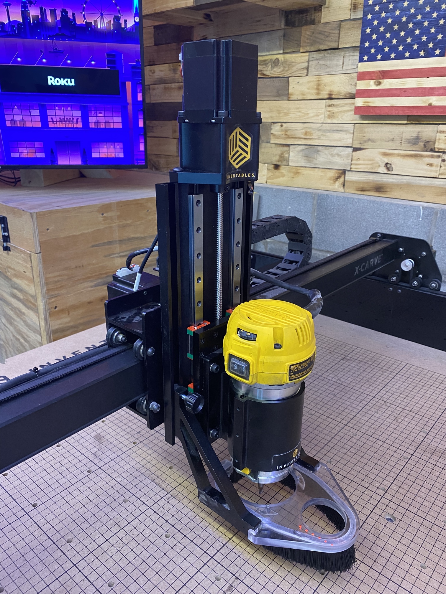

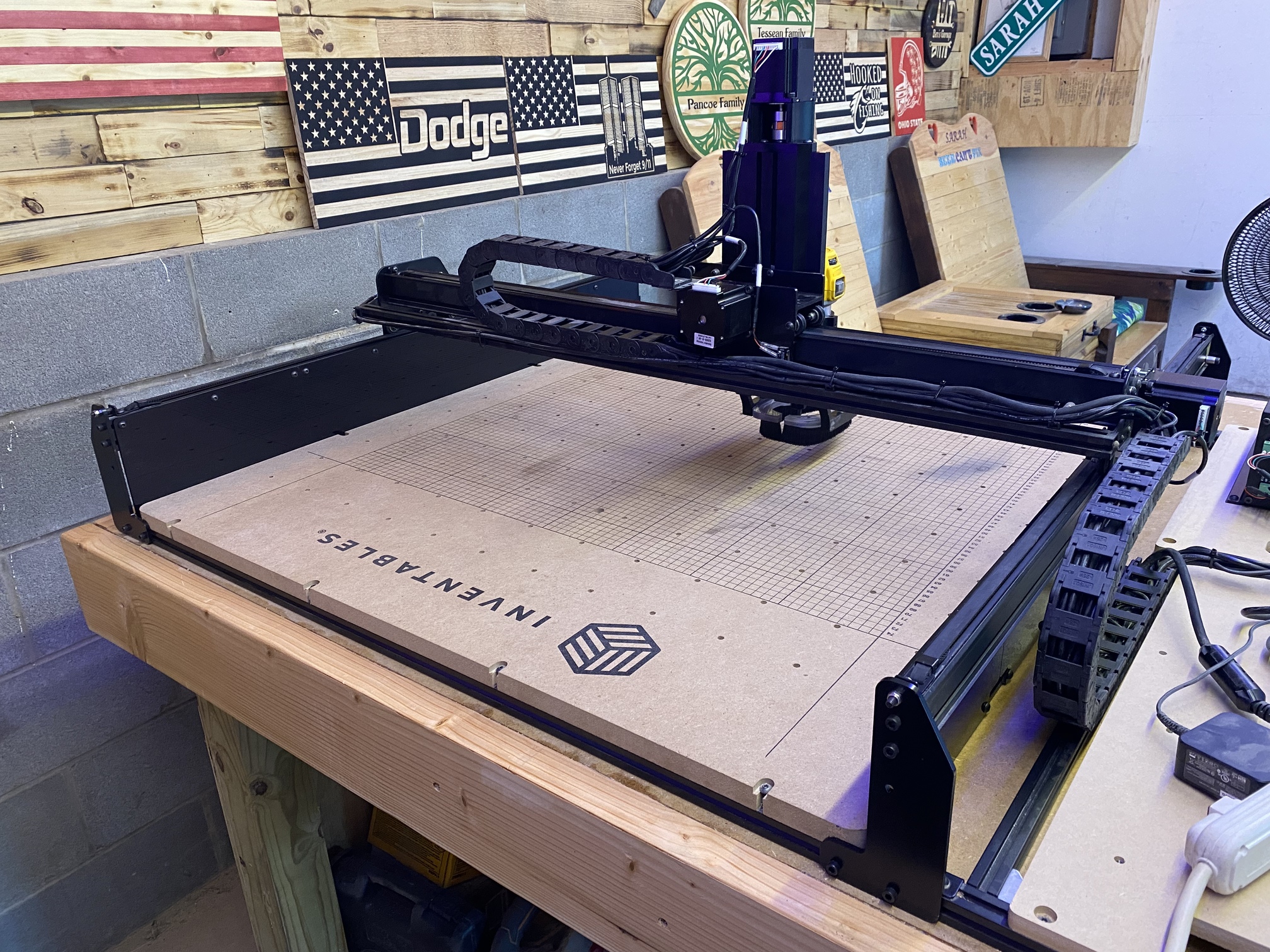

Inventables Xcarve Upgrade Kit Successfully Installed
About 10 hours on and off. Looks and runs awesome , no test carves yet.
Test carve on pine.
120 in per min speed, compared to my normal 65-70 in per min speed. Carved a whole detailed flag flawlessly.
Will try higher speeds next to see.
Looks awesome.
The new Z axis is much improved over the stock one.
Motors , wheels, belts, z axis, bolts and riser plates, stiffeners.
Seriously impressed!!

Did you have to move your Y axis stop back a inch? Cuss my machine hits the end of the belt now.

Tested 145 in/min for feed rate. .065 depth on an 1/8 down cut bit, and then .045 depth on a 90 degree v bit.
Plunge rate 22in/min I set it at but I think they have that set at only going to a max setting anyway? Dunno.
Total carve depth .055
Cut the flag amazingly.
I did notice that when building it that the wheels do run into the end of where the belt clips are. I don’t carve to that extreme sides of the machine so it didn’t bother me much. But good point at moving that stop bolt! Thanks.
How do you home your machine then? I use that corner to line up my work… Also noticed that from Z all the way down, it won’t home… Gives Alarm code 9 and stops 1/4" from hitting the switch…
You can make your home point anywhere when you start the carve.
See this as example ?
I get what you do. I run multiple same cuts so I have boards running down the Y and X so I can quickly use template tape and push my piece against them then stick it down instead of trying to move the machine to a start point. Why did you get the flag file? I have one I bought in .stl with and Eagle on it…

I’ve been considering purchasing the upgrade but I am unclear on how the panels serve to stiffen the Y axis. I see they attach to the sides of the Y axis rails, but do they also attach to the bottom frame? Otherwise I am not sure how they would serve a purpose other than keeping debris inside the cutting area.
Thanks!
look at the picture of the stiffeners here
