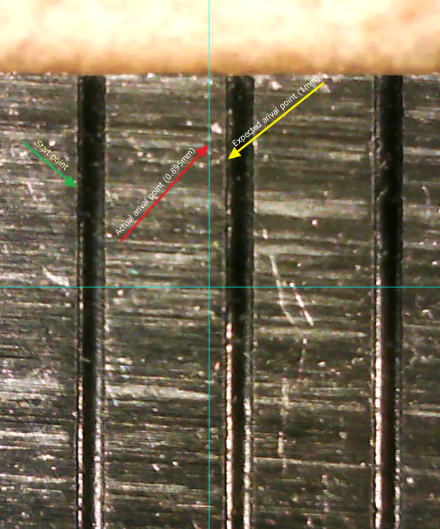

As I learn the wonderfull world of CNC with the goal of making 2 sided PCBs (printed circuit boards), I discovered that my x-Carve has some backlash (0.04mm) on the Y and 0,105mm on X axis, wich would explains some of the inconsistencies I found on my first PBC tries.

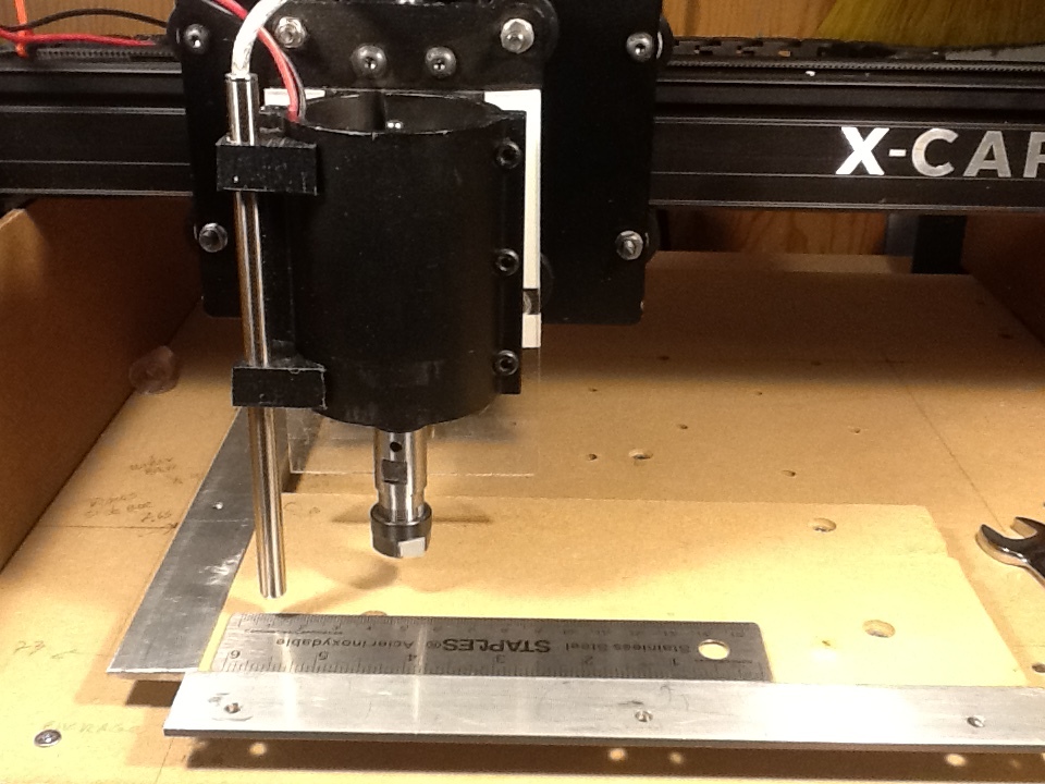

My tension is 5.5lb on the X belt for a 34mm belt lenght between belt roller and belt attach. The tension-meter raise the belt 1/2" over the extrustion. that makes a 34x17x17 triangle. (See pics)
I intalled a “microscope” on my xCarve. (see pics)
To reproduce the bug, I put a mm ruller aligned on my wasteboard.
I measure movements in 1mm increments and measure the backlash.
Results: the first movement in another direction after direction change (ie.: moving X+ than X-) is shorter that the subsequent moves, that are as expected at 1mm each.

Actual measurement:
USB “microscope” setup (sorry I had to remove the “inventable” logo to fit the holders…)
