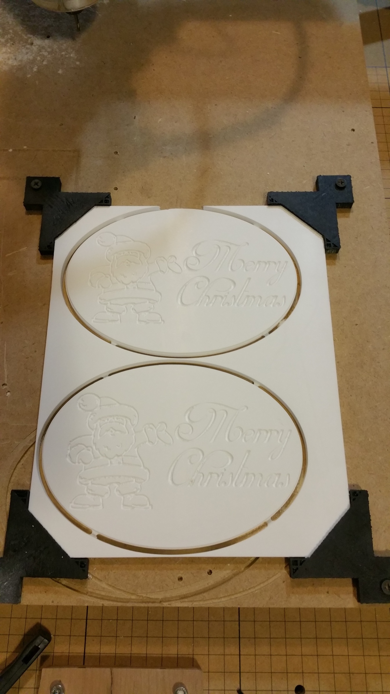

I wanted to show how I am holding the Corian down to the wasteboard with 2-sided tape. I am still probably using too much tape, but it holds well and I am able to cut out 2 of the signs from each piece of Corian without using tabs which makes cleanup that much faster. I leave the tape hanging off of the sides so I have something to grab to remove it.

hey eric I am curious as to why you just dont use clamps to hold it down and save the tape?
tape on the edges!
I was trying to speed things up…I had to make a bunch. I printed some corner clamps for these today and I am going to try that tomorrow.

With my little 0.125" bit I use to cut out the pieces, the corian will likely snap the bit if it shifts, just being cautious.

Here are the corner hold-down pieces I printed today…the two on the left are upside down. They will be screwed down to the wasteboard…We will see if it goes faster…I have more Christmas signs to cut.
I tried out the little corner clamps I printed out yesterday. I added 4 tiny little tabs to the cutout that sanded away very quickly, so Carve, loosen two screws, put in new material and repeat…I was able to knock out 16 more fairly quickly today.
