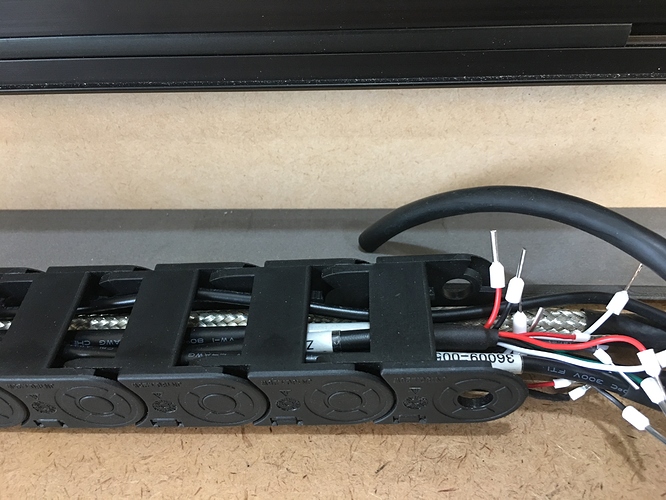

Thought I will create a topic to post some photos of my X-Carve build and projects as I get to learn the full capabilities of the machine. It’s a 750x750 X-Carve with the X-Controller. Machine ordered December 2016, fully assembled and 1st couple of carves March 2017.
First parts arrived…
Mechanical build complete…
Suckit arrived and fitted…
X-controller assembled…
And finally, progress thus far. First couple of carves done for the girls without any major final tuning or calibration. I’m super impressed with this machine. The team at Inventables have done a great job putting these kit sets together. I was leaning towards the Openbuild OX but happy that I decided to go with the X-Carve. The machine, support and community forum is excellent.
