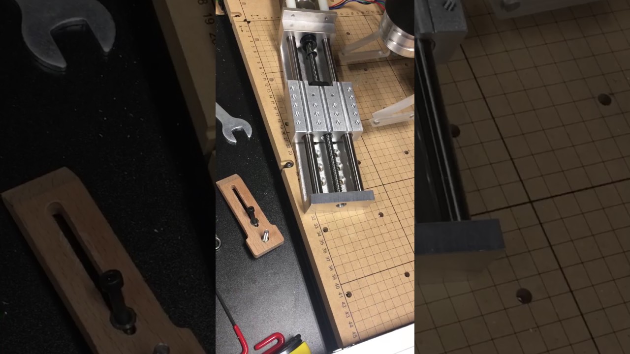

It’s alive!
Action video: https://youtu.be/tHy3rpnKSgw
A few notes:
  1. very little mounting slop for the Z axis to the carriage. Kinda sucked but I made it work (for now…gotta skim and see how it looks)
  2. I’ll be able to put Charley’s raised Y plates back on and not have any problems reaching the wasteboard.
  3. The Dewalt sticks about 1/4" out further than the hole in the SuckIt which doesn’t have adjustability outward like that. I’ll put some spacers behind the aluminum channel (ones I had left over from the stepper) and it should solve that issue.
  4. Switching out the eccentric nuts with the spacers was both a pain but also so needed. It’s amazing the difference between the two methods.
  5. homing works perfectly with the switch mounted and it looks clean.
