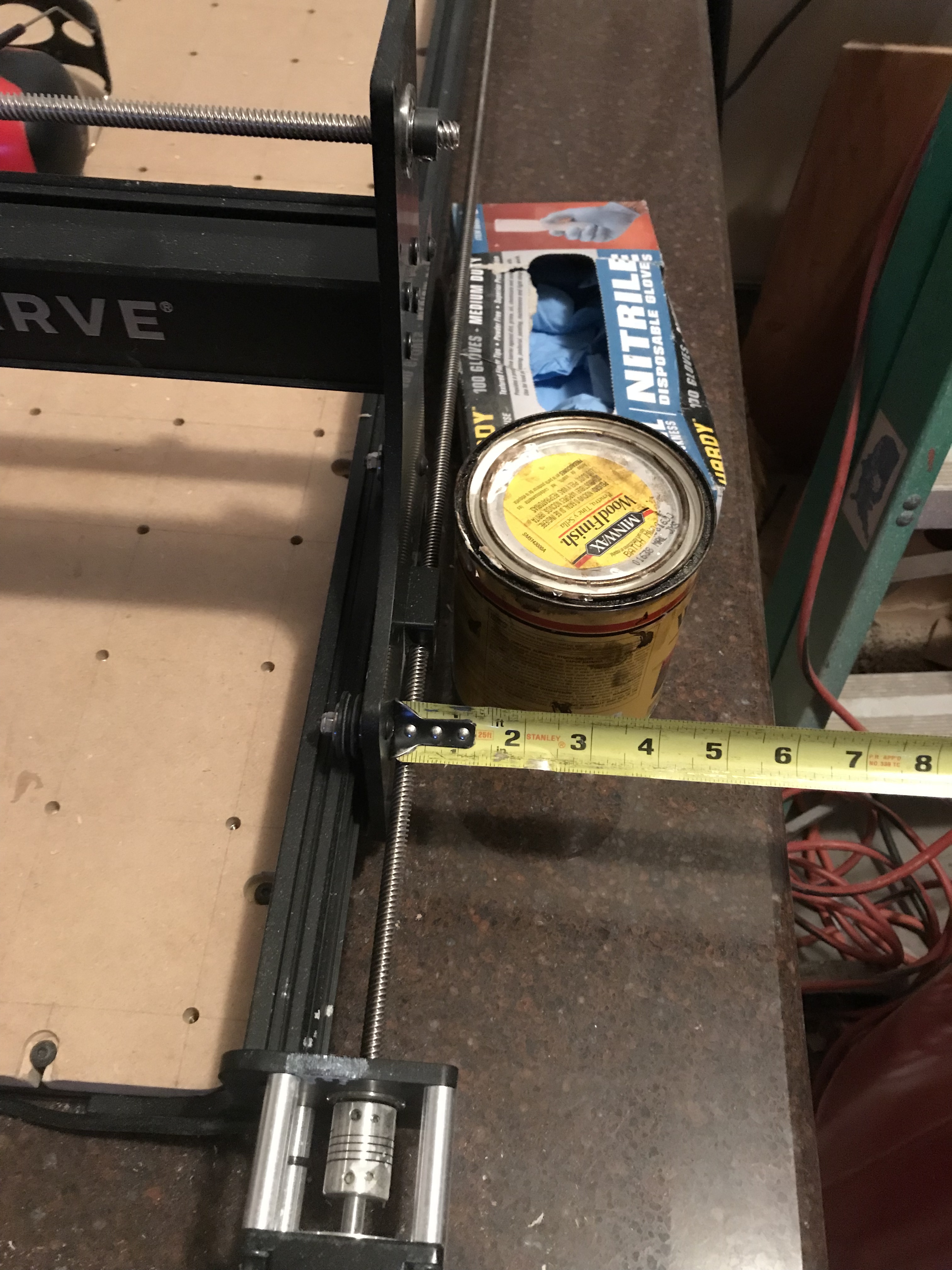

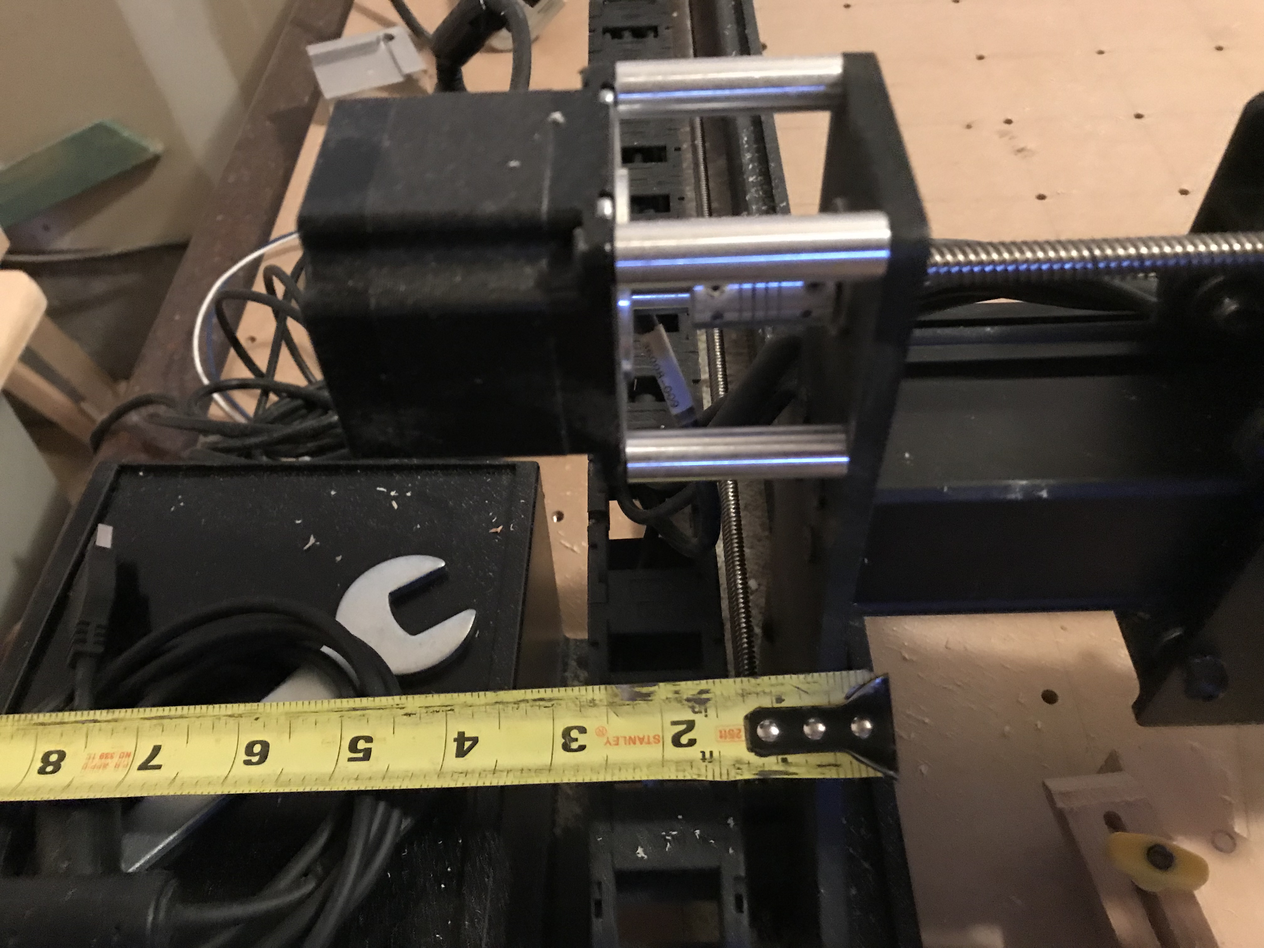

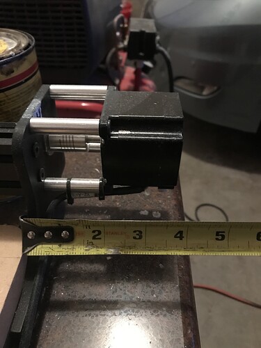

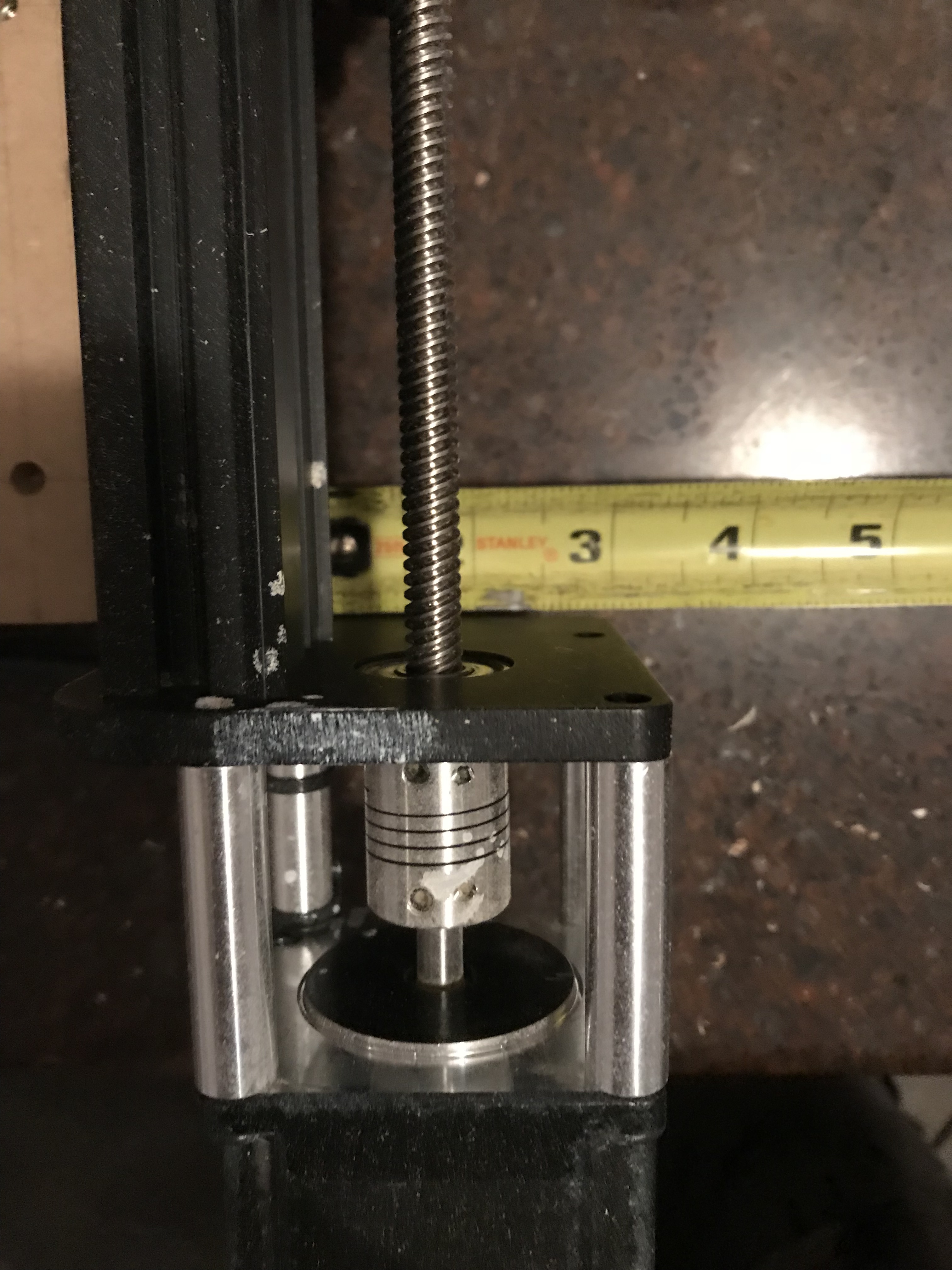

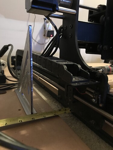

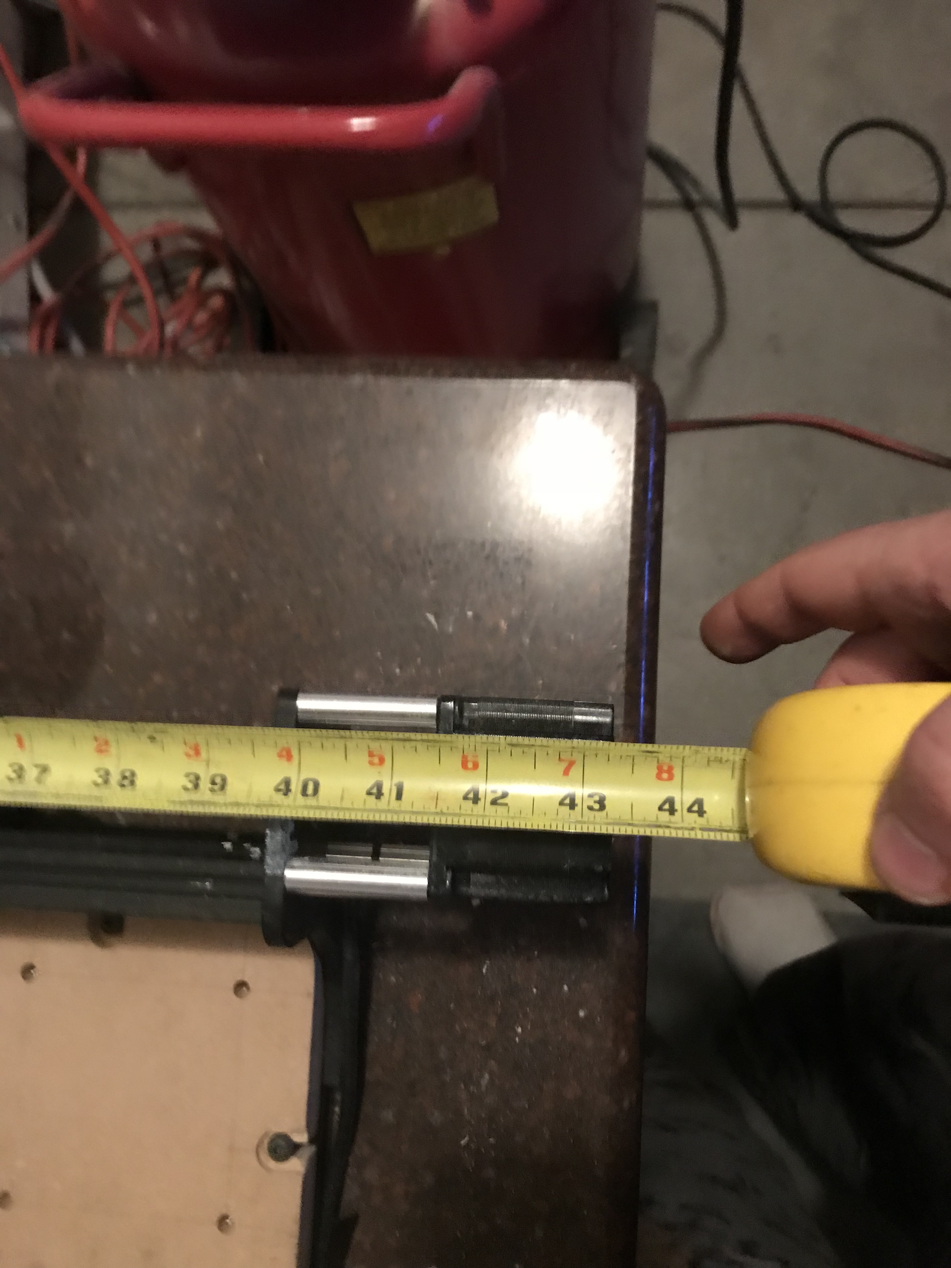

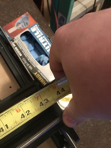

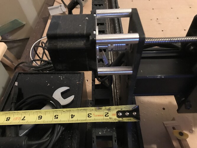

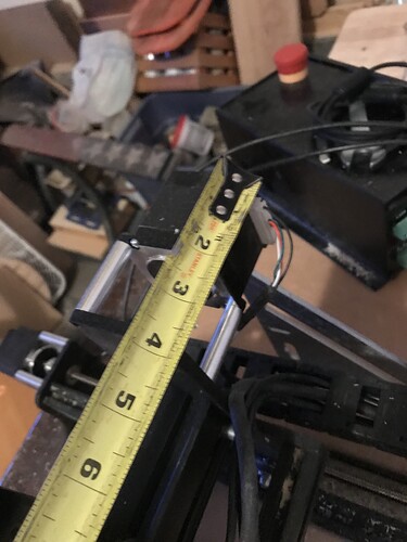

Hi Jeremy, my X-carve table folds up against the wall when not in use, due to lack of room, so I need to make it wider to get the new end plates to fit, what is the distance between the X-carve sub -frame and the end of the new Y plate, how much wider than the existing plate is it , from looking at your photos it looks to be about 2 1/2 -3 inches
Pictures may help with understanding the question as you mentioned a few dimensions and was not specific

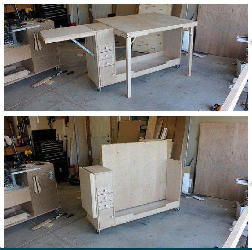

I have something like this, just a sheet of wood each side no drawers and it is fixed to the wall at the back, the X-carve at the moment is the exact same width as the table and just clears the side pieces when pivoted, so with the new end Y plates being wider to make room for the linear drive screws, I need to make the table wider, just wanted to know by how much, space is tight, so I need the total width of the X-carve with the new plates please, I hope this explains it a bit better
Overall Right to left is 45in
43.5 from outside of x motor on left + 1.5 from outside of the right side side-plate to the outside of the right-front motor
Thank’s Jeremy, excellent photos, that is all the information I need
Larger front to back as well…
Thank’s again Jeremy, you have been a great help
