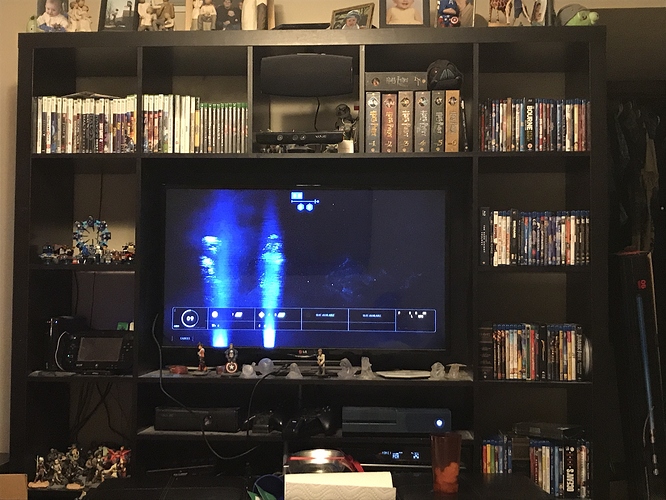

So even glueing and screwing the skins to the units wouldn’t be effective? How is that different from any other method I’ve seen? I’ve got quite a few IKEA shelving units and they’re surprisingly sturdy.
Had this one for years and it won’t deflect a 1/4” if I put my whole weight against it.
