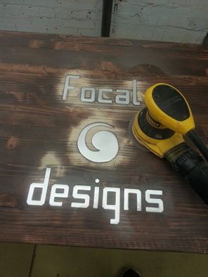

I made it for a Makerspace. I did the TV sign in the background as well as flattened out the table.
Then an aluminum inlay:

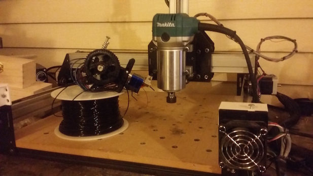

Thanks! Here is my garage build.
Took the large build to Houston last weekend to make some modifications to the frame.
Was out working on the garage build again. I got the 4th axis on today.
Also had to do some wire management since I welded the computer side on the wrong side.
I didn’t have any 80mm x20mm extrusion so I just printed up some joining hardware.
All clamped up and ready for drilling and bolts.
And we’ll skip to the good part.
Ended the night with cleaning out some space for the electronics.

Here is the inside of my control box. I want to add an arduino with a digital switch to switch the step and direction lines of the XYZ axis’ between the arduino and beaglebone. That way I can use Easel and Machinekit/Redeem. I like that Easel is very easy to use, it’s apps, and the ability to share projects. Still researching digital switches that can switch multiple lines.
The board is a Replicape RevA which supports Machinekit allowing me to use the 4th axis. It will also allow me to research and build a 5axis head. It is originally a 3d printing board running Redeem which allows me to 3d print easily.
