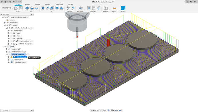

As I now have a CNC at my disposal I wanted to put it to good use. More specificly, do a recessed mounting flange and surface contoured front baffle with precision
So Fusion360 is my go-to design enviroment and I made a model:
My CNC is limited in terms of X/Y machine area and the baffle way to long (2076mm to be exact) so tiling the carve process is my only option.
Here is my solution:
I made a 2nd board surface with side walls so my stock MDF sheeting stay parallell til Y-axis and I can shift the MDF incremently to do each “tile” with precision and accuracy.
Here you can see the first “tile” out of the machine, with pilot and guide holes shown:
The process is carve each segment out, lift and shift the MDF board according to pilot hole and repeat.
Since the full baffle have a top and bottom that is different compared to the middle ones I needed to split this into three groups, one for the top, four middle and one bottom. 6 tiling operations needed for one baffle and each tile represent about 30min of actual carve time. So 3hrs per full length baffle.

In total the carve was primarely done in 12 operations per side, but each operation could have different tool strategies like 2D Contour for cutout, flanges, finishing pass.
Also had to carve fixtures to ensure I would tile with precision, so not counting the flaws and failed carves it took 24 separate runs to get the job done…
CAM done in Fusion360 and used UGS 2.0 (Stable) as sender.

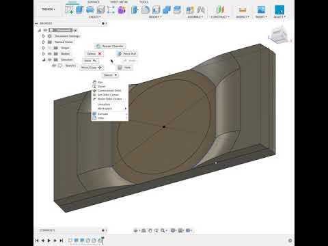

Wowzers, the slow-mo video was cool, thanks for the upload. The only thing that I personally would like to see is the process in how they were designed in Fusion 360 to see how the software is used. This project has inspired me to finally give it a shot. I’ve been putting it off because I just don’t have the time to learn yet another program but I’ll suck it up to better my output on projects, having the ability to contour something like you did here is, to me at least, next level and could take my designs to the next level. If you’re interested in taking up the task, would you be willing to make a short video on how you created the contours for the face of your project? Doesn’t have to be the exact project, but just to show an example of how one would achieve such a result? It would be very helpful, thanks again for the uploads and keep us posted on the progress, I’d love to see your step by step process in how you finish this thing up. It’s going to looks amazing when it’s done, again, well done homie!
That was awesome! Thanks for the upload. I’ve since watched a couple of tutorials on Fusion 360 and it looks like it won’t be too difficult to pick up on. That we every informative, thanks again!

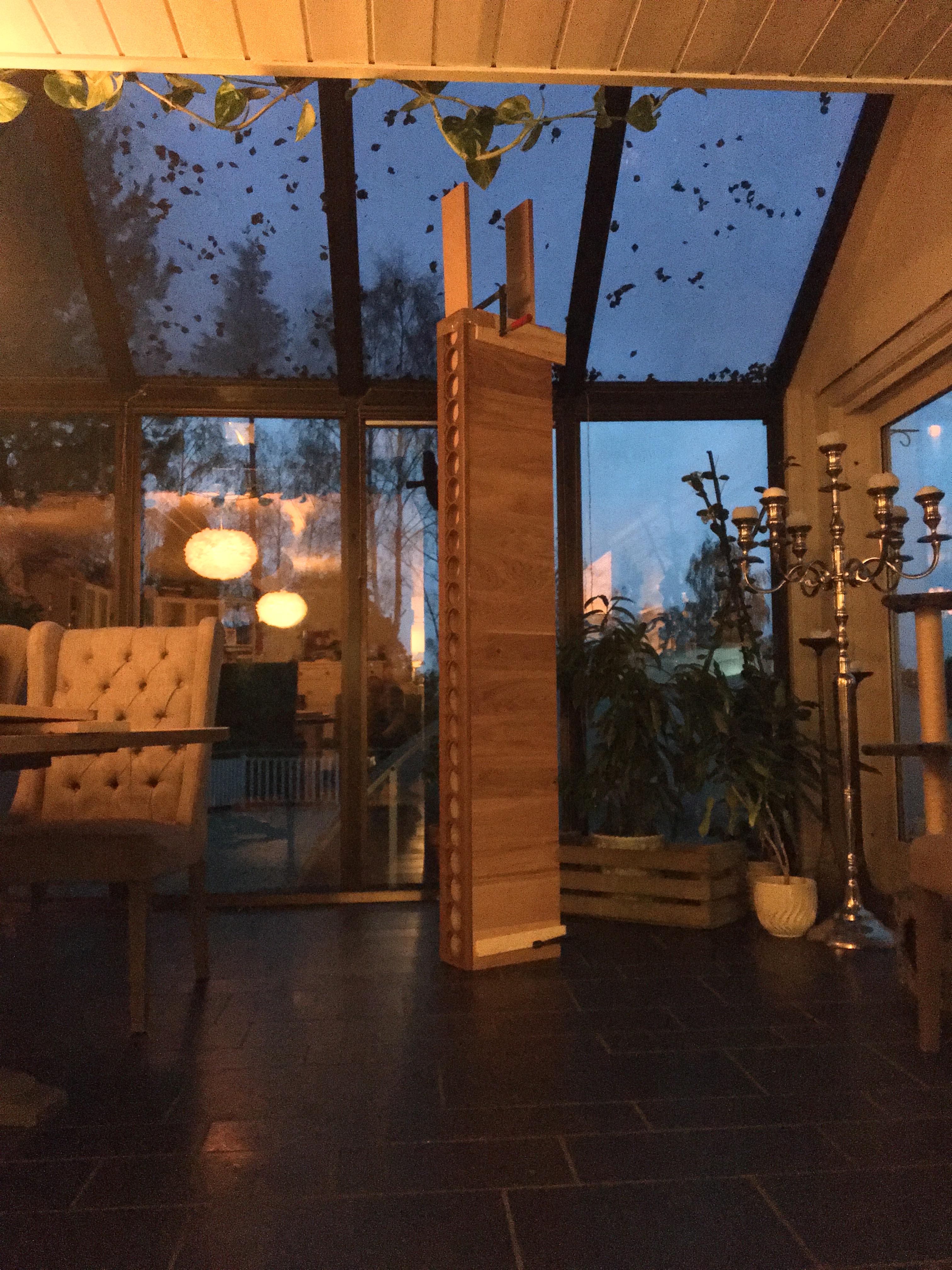

After using a circle saw to cut the cabinet sides to size, a mandatory “what does it look like” had to happen, so clamped one up for a quick peak. Laying on the floor the size doesnt look all that, but once upright - boy it it tall
