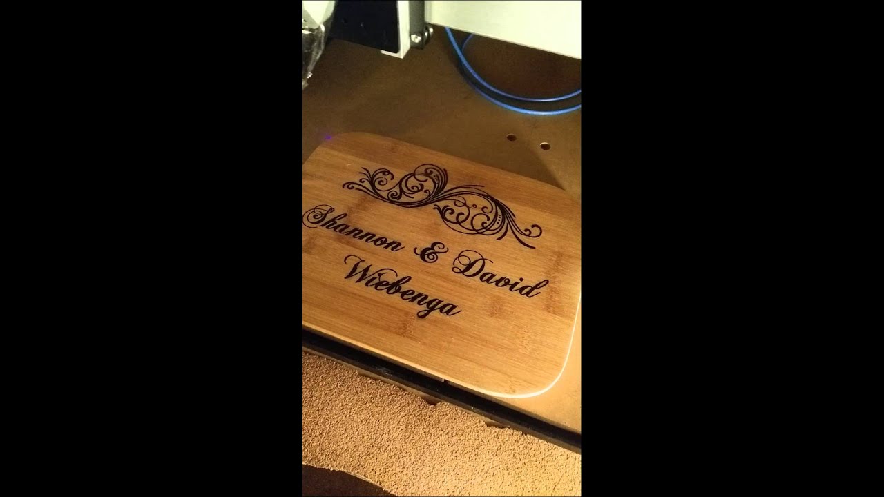

Not sure if I should place this here or in the laser cutting section. Either way this is a completed project. A gift for my uncle’s wedding. 2 passes with a 3 watt laser
Edit
Here is how the program runs
The short video is on the second pass. I did take a 30 second timelapse, but don’t know what program to use to edit.

I backed the laserink Kickstarter. I know he purchased them from a very popular seller as I have a spare diode, but just can’t remember the name. Yes this is VERY hazardous to your eyes. ANYONE THINKING OF DOING THIS SHOULD USE PROPER EYE PROTECTION. I have 3 sets of goggles if that gives you any indication. Also beware whatever being cut/engraved can emit harmful fumes. So in the future should I post completed laser etches here?

That is really nice Frank. How are you finishing it after lasering? Some forms of food safe oil?

Thank you! Still pretty new to the laser scene. I used some butcher block oil, since I know they will end up using it. Thought about epoxy, but didn’t go that route.

Here is a second example straight off the laser. Only one pass this time. I messed up and it slid a bit before running the second attempt.
Edit: No lie, this is just wedding month;they are all gifts so no moneys :frowning:
Nice. :smile:
One of the “benefits” of lasers is that you don’t have to clamp down the material. But I’ve found it is worth doing just in case you need to run the job again to make it darker or to run a couple more passes if cutting etc.
