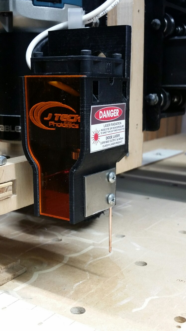

Just installed a J-Tech 2.8 on my X-Carve and am messing around with it - very impressed so far. This is my first laser so a lot to learn. The new magnetic mount and shroud J-Tech has available is a nice addition. But the shroud does make it harder to set the height above the work surface if I try to use the suggested heat sink as the reference point. I have interpolated the height to use the bottom of the shroud but I question the total accuracy.
So the question is - How critical is this measurement. Are we talking within three decimal places like we set the Z on a bit? (I’m working in inches) I have varied it up and down a .01" or .02" and really can’t see much difference in the burn line. I certainly would see this difference with a bit.
Been thinking about rigging up way to use the probe to set this right on the money but wondering if it is necessary. I “pretty close” good enough?
Photo of the shroud.

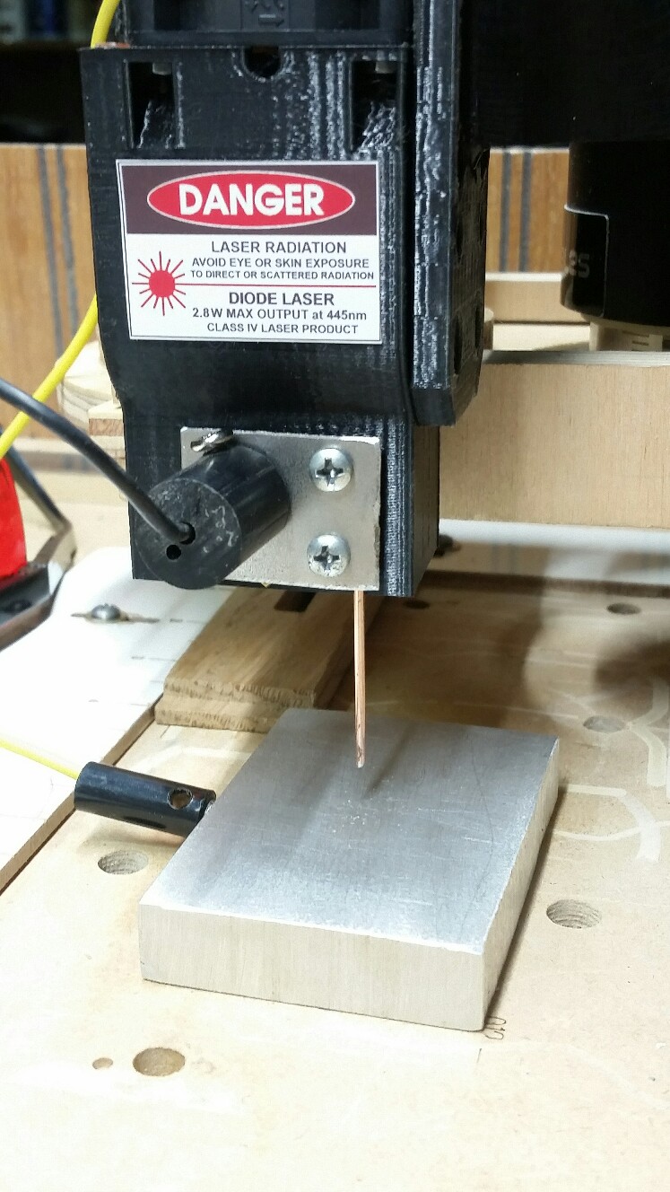

BUT, I have added a working “Probe” on the side of the laser’s shroud. I can use it manually by just sticking my touch plate under it and slowly lowering OR attach the wires and do the full automated probe.
Did you make the working probe or did Charley come up with that?
It’s nothing special, I just scrapped it together. A little flat piece of steel with two holes drilled. I did stick it in a vice and bent the one edge over a little to better hole the rod in place. It would not need to be that big if you weren’t going to attach the magnetic contact to it.
The rod is just a piece of gas welding rod cut to the right length. Any somewhat stiff wire would work but the welding rod was shiny and I liked that! :grinning:
