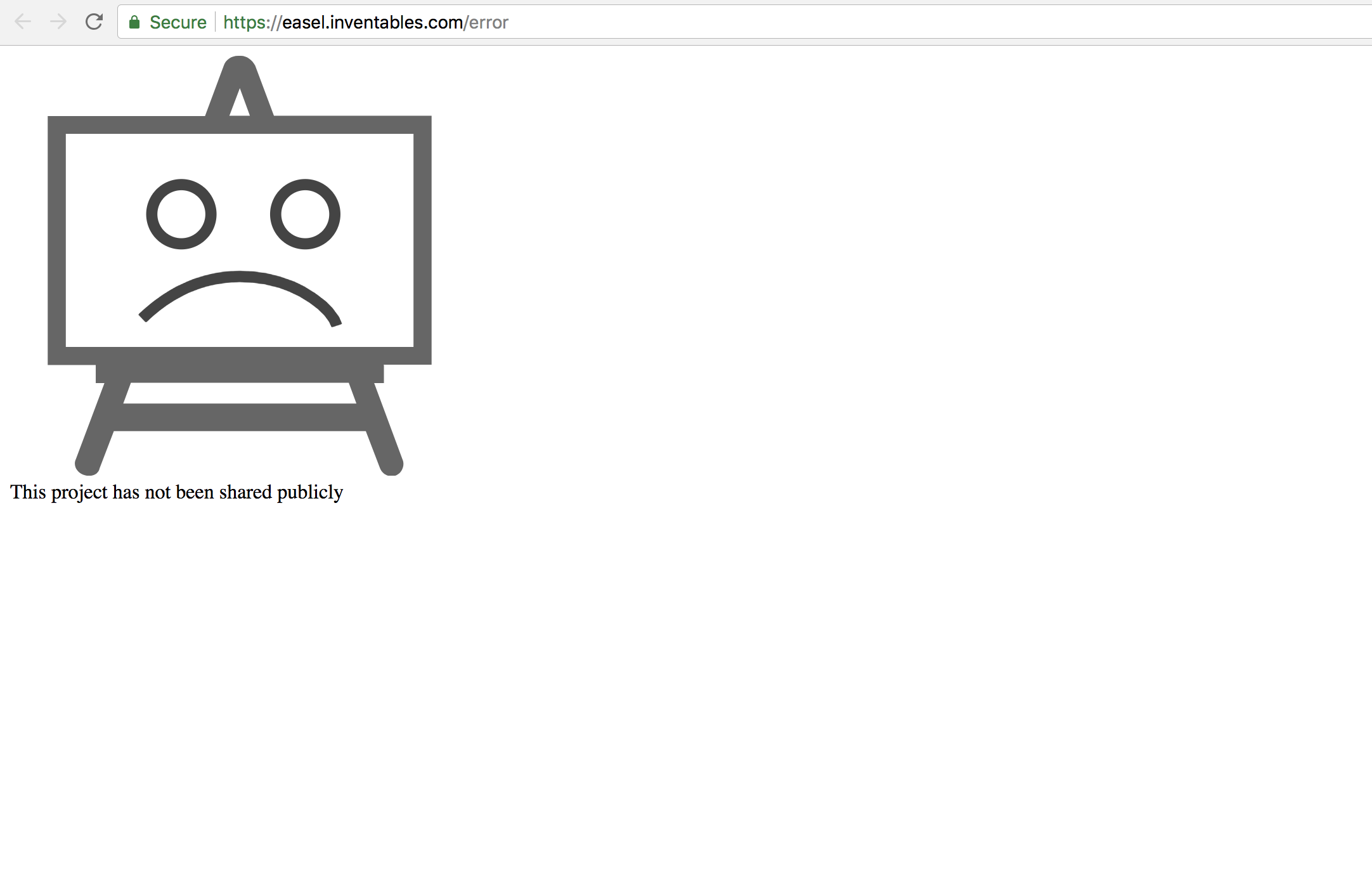

@JeremyHarrison do you want me to try and run yours and send you the gcode? If so please change the sharing permissions. Right now it’s a private project.
http://easel.inventables.com/projects/vxG9KVa9Hmw4r_c3mbNI5Q
Try it now. If this don’t work I’ll have to do it when I get home and have the computer and not the cell phone.
If you send the g code what does that do. Sorry I’m new and still learning all the ins and outs.
When you click share make sure you hit save before closing out. still not working.
I just tried the first shared link I am freezing at the same spot as his screen shots.
