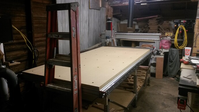

So I bought an x-carve oh idk 8 months to a year ago and started to get some jobs. I got 1 job in particular which I needed to cut out over 300 brackets for a guy and decided right then and there I am going to take the plunge so I set the x-carve aside and bought a 4x8 machine with all linear bearings and will run up to 1200 inch/min
I look back at my X-carve and am just amazed at the differences
I will still use my X-carve though and might turn it into a dedicated laser engraver

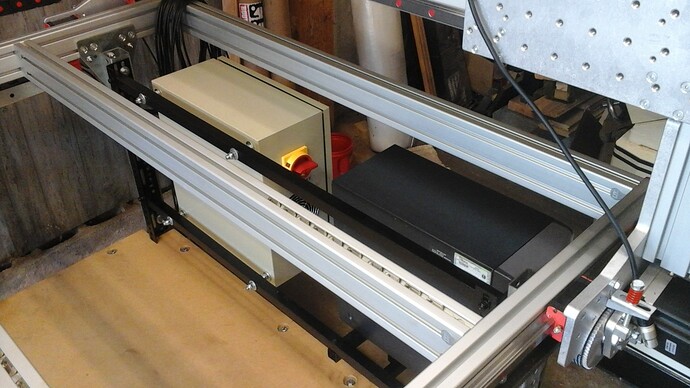

its a CNC Router Parts PRO4896 the latest version all linear

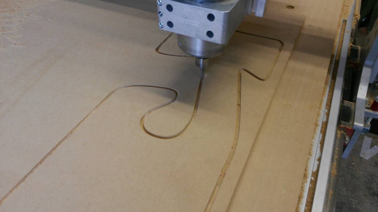

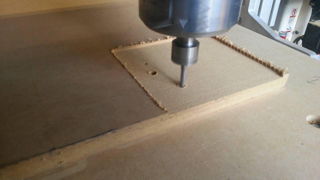

and yeah like in the videos I am only running 300 inch/min at max and thats kinda babying it for this machine

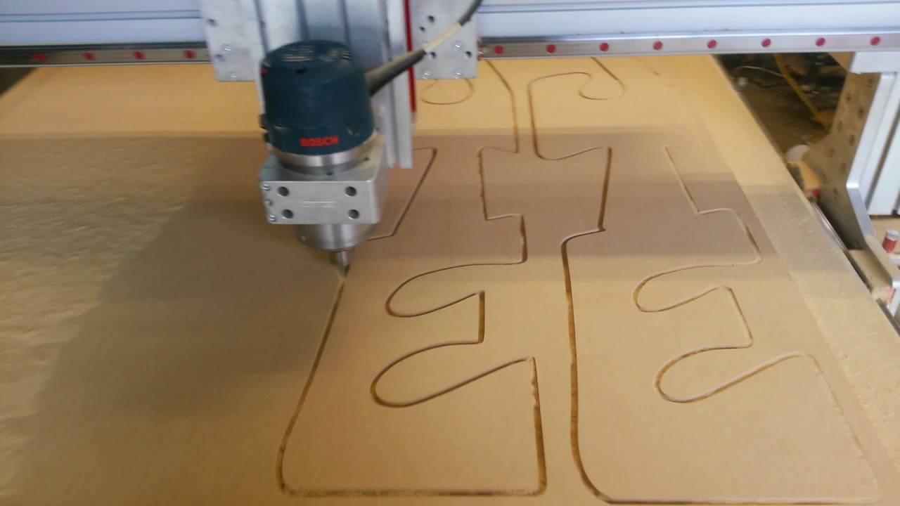

I think it was a bad choice to go with the Bosch router though I should of just bought a spindle and vfd if I was smart even at 300 inch/min that bosch is bogging down I need more power
I am using the Bosch 1617 on mine and it has been doing great. I can run a .5 inch endmill at a .25 doc and 200 ipm with no trouble
Yeah I keep talking to my tool rep and he wants me to run my tools harder I have been running at 300 inch/min and .5 doc on speed setting 5 on the router
he wants me to ramp into a .75 depth of cut and run up to 800 inch/min I just dont think the 1617 will handle that lol
all with a .25" tool

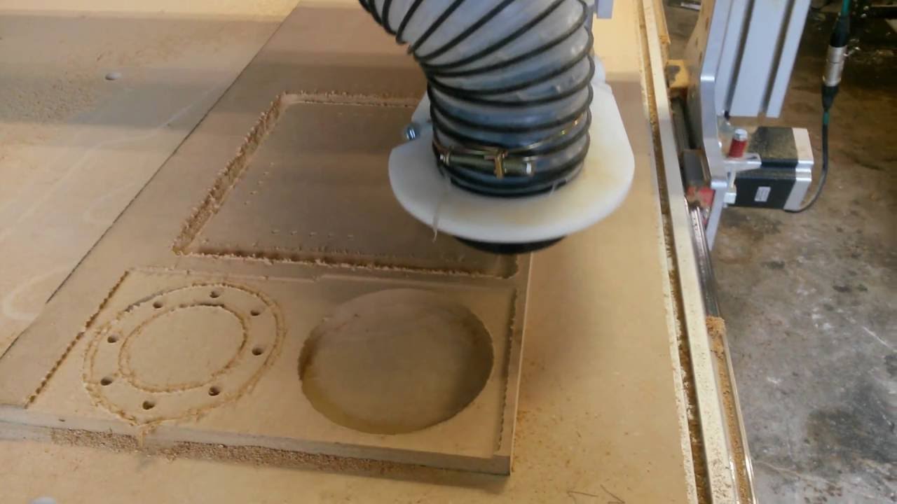

What kinda dust shoe did you get for your machine?
