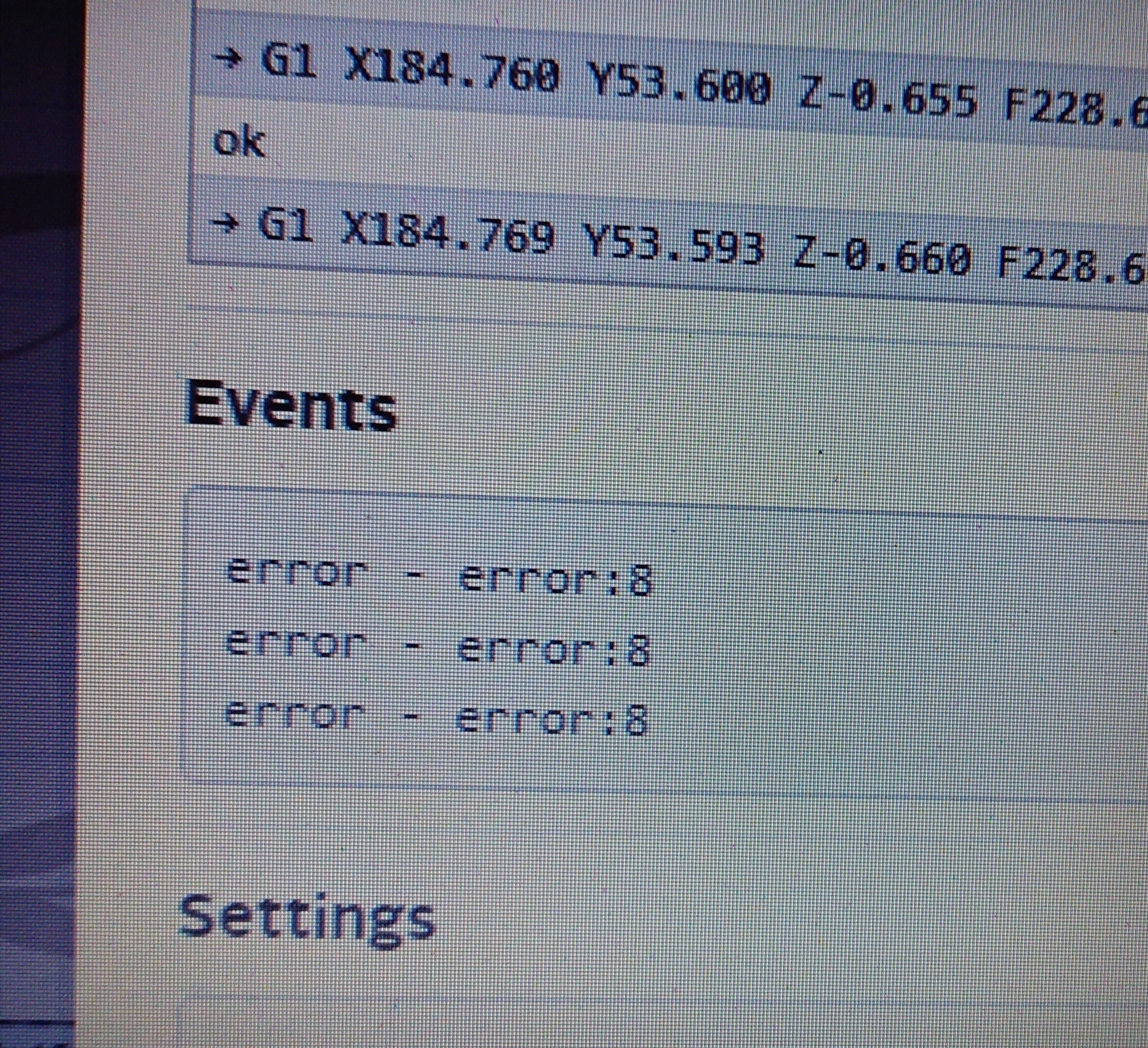

I have a question, what version of grbl do you use for lightburn and for easel?
I had version 1.1e but in easel there was a bug 8 and it was stopping work.

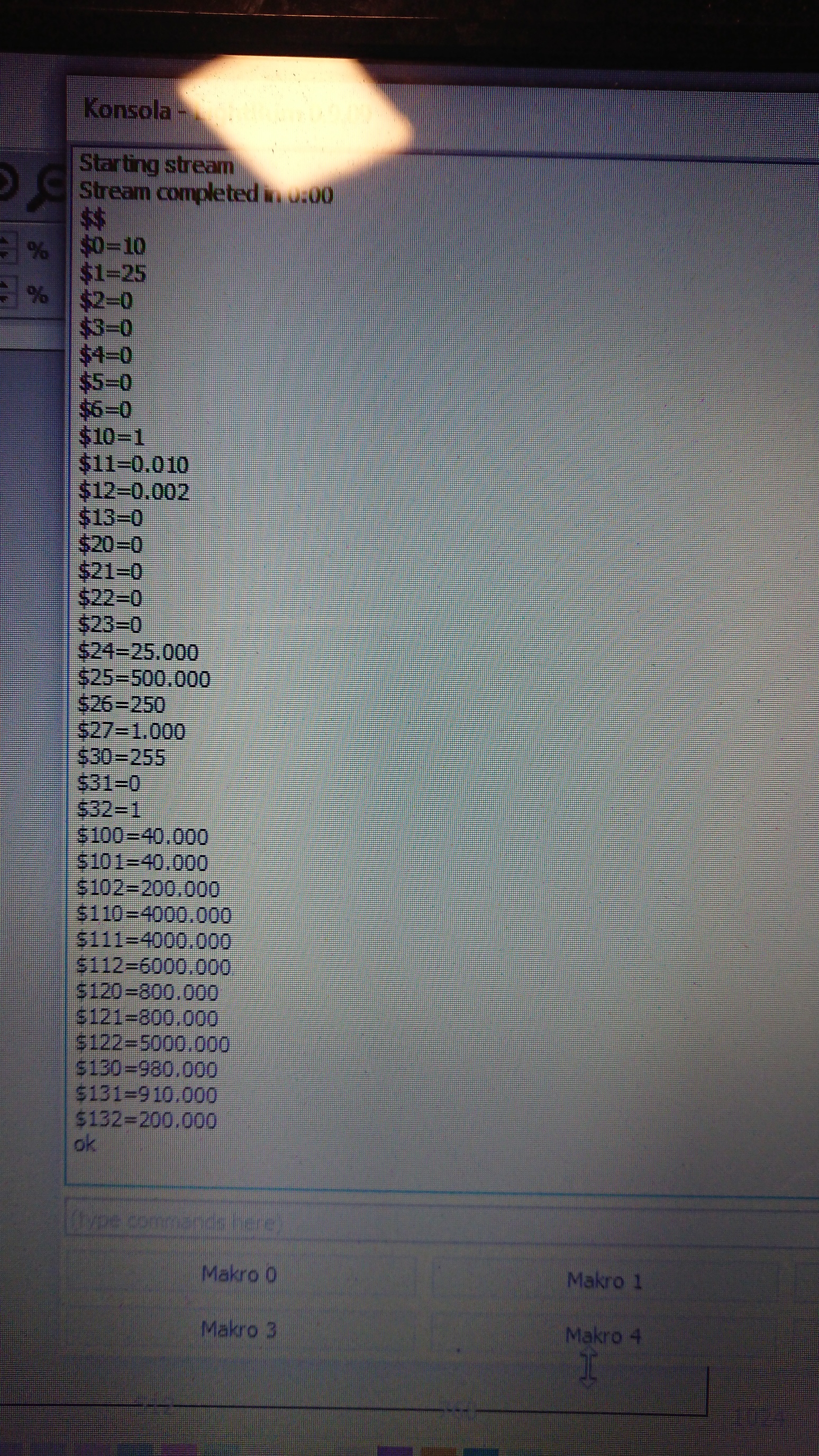

I loaded 0.9 and works well in easel but there is no $ 30 and $ 31 adjustment for the laser
I had versions 1.1f and 1.1h but it was the same as with 1.1e.

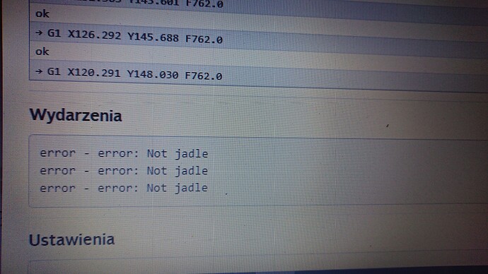

now I have 1.0c
and displays in error easel “not jadle” what does it mean?
Do you have any advice?
1.1f or 1.1g
also with 1.1f and 1.1g gets error 8
carving stops during operation
Based on this post (error 8 lightburn – K40 Forum) error 8 happens when the machine cannot home. Do you have homing switched installed and working on you X-Carve?
I don’t have them, do I have to install them and will it be okay? Can it be easily turned off?
And let me add that in lightburn I don’t get any error just in easel
When you go through machine setup in Easel it should ask you if you have homing switches. Maybe run through Machine Set Up again and verify that when prompted for that question you say “No”?
Configured a few times and nothing worked
I uploaded through easela grbl 1.1g I configured and continues to display error 8
