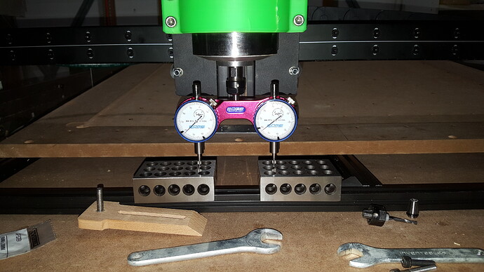

I picked up a tramming tool and it made a world of difference!
Yes except it is producing this pattern at the top of the piece and an inverted version of the pattern at the bottom of the piece.
