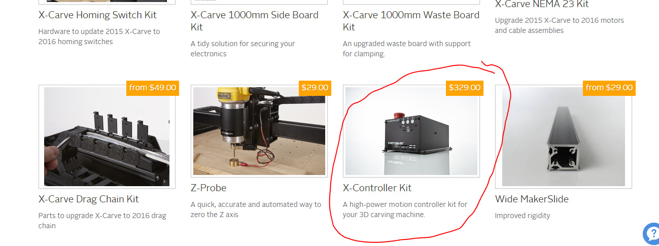

Have you looked at the component offerings?
I don’t see any gShields there at all which would speak to what I was told.
I would not recommend g shield.
Go with the X Controller. Found under Machine Upgrades.

And I’ve replaced all kinds of the parts on mine, I’ve actually replaced the shield before, but apparently they don’t carry the shield any longer, and as I’ve mentioned before, I can’t afford the $300 upgrade.

gshields are still plenty available, so are other cheap controllers.
While you wait for potensial offerings, what is currently wrong with your current gshield?
The gshield is really a weak link and a I would strongly suggest you seek different solutions.
The Xcontroller is one turn-key solution, but at a price I understand you are not capable of doing.
If you dont mind tinkering, a similar controller can be made for very cheap, basically an Arduino UNO or Nano, coupled with TB6600 individual drivers. Check Cragislist etc for any remnants of such, they are cheap new and should be dirt cheap 2nd hand.
Upgrading the controller/stepper drivers will be a massive upgrade compared to the gshield.
