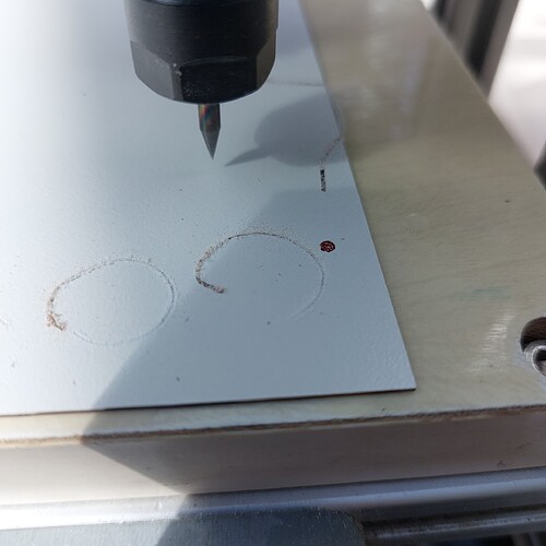

Hi Seth
Here is a photo and short video of whats going on,
Not a round cut,
Not a complete cut,
Losing depth, usually lot more loss of depth actually raises up 2 or 3 mm
Thanks
Steve
what model cnc is this? I thought this was an X-Carve but that looks like a 3018…
What are the cut settings? (Feed, plunge, depth per pass, plunge ramp angle, etc.)
Hi Seth
Yes 3018,
Feed rate = 80 per mm
Plunge rate = 340
Depth of cut = 0.4mm per pass
Not sure what you mean by plunge angle though, sorry,
My step over in the bit settings is 0.2
As you can see i am using a narrow angle vee bit but easel doesnt have this option in the non pro version, neither does carbide create, so selected default 60 degree bit,
Was cutting ok now does this,
