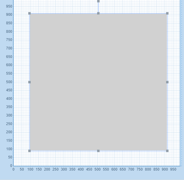

Can you share Easel project?
How big is the rectangle you made to cut?
I’m in the house, but will send tomorrow. Basically it’s a 32x32” square. I am making a new wasteboard and the forums almost always say to a bottom cut bit on the entire board is the best way.
Realized I can send from my iPad. One of the few good things about files being in “the cloud”
Your machine cuts 750x750mm.
Your square to carve in that file is 32" x 32"…that’s about 813x813mm. Too big.
You also have the square randomly placed in the work area, so the lower left corner of your carve is already about 4" in on the X and Y.
You want to set that up so the bottom left is at the origin. The size should be 749x749mm. If you use a large facing endmill, you’ll clear enough.
If you don’t need the full Z range (most don’t), I’d recommend a supplementary wasteboard on top of the other. That way, you can surface the entire area.

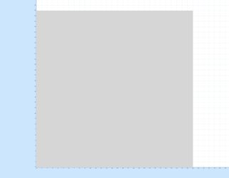

Thank you. I changed the rectangle size and it worked. Hopefully I got the opportunity to pay it forward and help someone.
