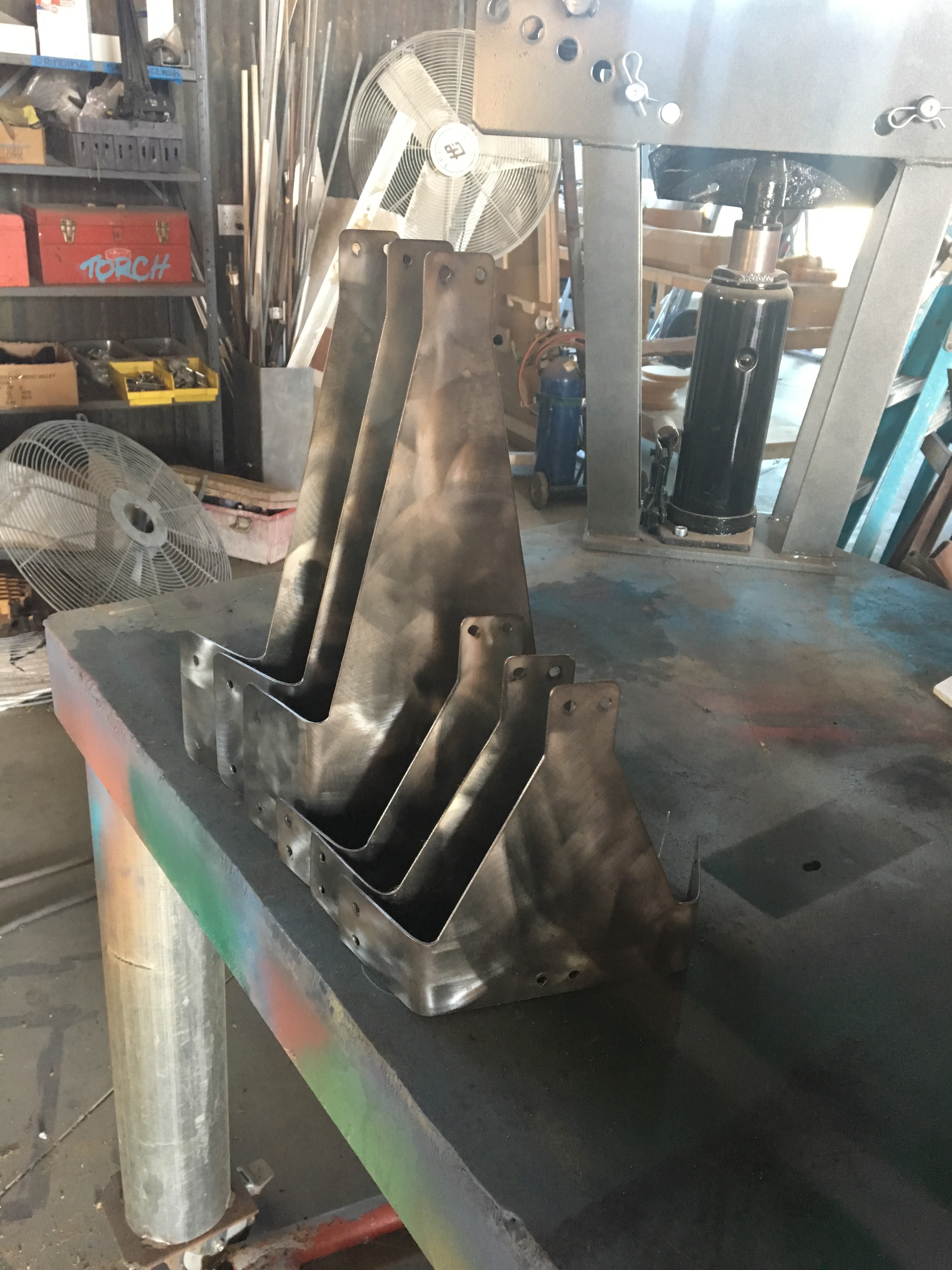

FYI the machine will work ok without steel side supports. Pwr supply is screwed to top(under heated bed) with smoothie boards under that. This way I can have access to the smoothie.
