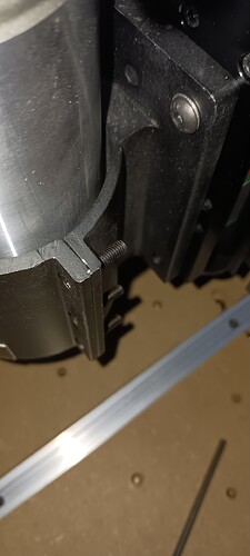

Then the makita router doesn’t fit the spindle mount.
The box is clearly marked “makita spindlemount.”
The body of the makita measures 2.551".
The mount measures 2.65" as best i can tell without borrowing a bore gage from work.
Is it possible that the mount got relabeled from an unused stock of dewalt parts?
I have a 3d printer so i could print a sleeve, and i have a lathe so i can turn an aluminum sleeve, but thats nonsense for a 2500 wonky piece of crap.
Im tempted to send the entire heap back in a crate, let them sort the mess and demand a refund.
Who exactly did you purchase this from? Directly off the Inventables website or through a reseller? definitely looks like old stock of the DeWalt 611 style 69mm size mount. I sell 3d Printed Shims through Etsy for ppl not wanting to buy the metal one in the right size when upgrading older machines so if you want the model it’s on thingiverse already drawn up, but I’d call up Inventables again and get them to send the right one!! You can also shim it with some pieces of aluminum can careful cut from the sides of the cans to make sheets, about 3 or 4 sheets and it’ll take up the air gap. at least until the replacement arrives.
Yep, straight from inventables. Contacted support again yesterday. Will wait and see what they’re going to do about it. Already modeled a temporary adapter and printed it last night just to keep going with the build. I’m not entirely sure why they didn’t just use the same extrusion for both and add a sleeve from the start…
