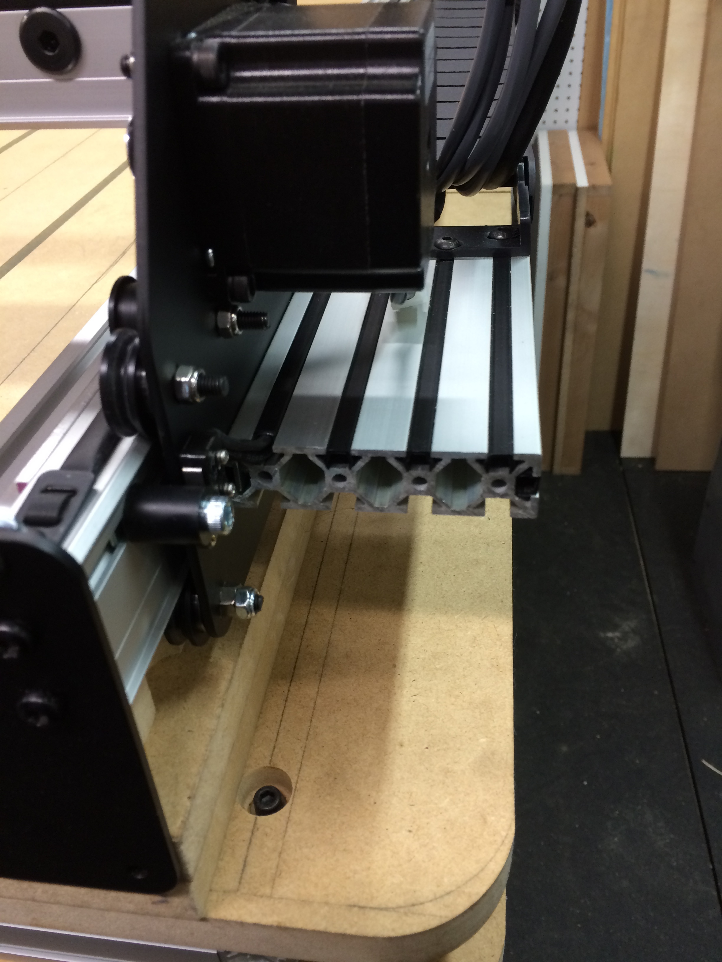

I upgraded the Y-axis Rails to accommodate 1800mm Makerslides. To reduce any Side to Side flex, I bolted a 20x40mm extrusion to the inside of each Y maker slide. I attached this 20x40mm extrusion to the maker slide using 3/4" aluminum angle iron, Drilled every 6" on alternating sides. This took away all side to side flex. In Hindsight, i would rather use 2.5" angle Iron for this attachment. This would have done two things. First, the piece of angle iron that runs horizontal and attaches to the 20x40mm extrusion would hang over the edge about an inch (this could be trimmed down some on a table saw if so desired). In Theory, This flap would help keep dust from blowing up as bad at the edge of my table, if anything it would force the dust back toward the center of the table. Then the Vertical arm of Angle iron will act as a dust shield for the belts on the Y rails. If i recall correctly this vertical dust shield could be up to 2 3/4" tall. This entire modification adds substantial increase in strength and rigidity, not to mention dust shields (if using taller angle iron), to the Y axis.I am very Pleased with the results
Since I decided to scrap the entire waste board area of my machine, I needed something Flat and stable to replace it with. I chose to build a torsion box from 20x40 and 40x40 extrusion with 3/4" MDF skins on both sides. This table does have a few hidden designs but those are null and void at the current time, modifications are scheduled in the future. I am Very happy with this temporary table. soon I will be rebuilding the table with a torsion box built of 18ply baltic birch, in much more of a permanent location. for now it is on top of a spare workbench with the back of the machine supported by a saw horse. The Table is heavy and solid for this machine. thought about filling it with sand, but figured that would be over kill, not to mention cleaning up the sand in the shop and my aching back if and when I have to move this table.
I decided to use the endplates basically just for belt tensioning mounts. This required an alternate method to attach the Y rails to the new table. I chose to stack four pieces of 3/4" MDF, in Hindsight I wish that i had chosen six or eight pieces, but for the stock Z`axis, four layers (approximately 3"/76mm) IS the Perfect amount. Eventually, I will be modifying the Zaxis, when this is performed, then additional risers will be installed.

These modifications result in Exactly 3.5"/90mm of Clearance for the Z-carrage. This allows for the exact same measurement for the Spindle, SO it is MAX capabilities with the stock Z, and this is with the Z axis Lower V-wheels right on the end of the stock maker slide. Of course this will increase slightly or decrease slightly depending on the extent of surfacing performed to the new work surface.

The Z-rails included 1 1/2" aluminum Tee between the maker slides and 7 furniture bolts holding it all together.
