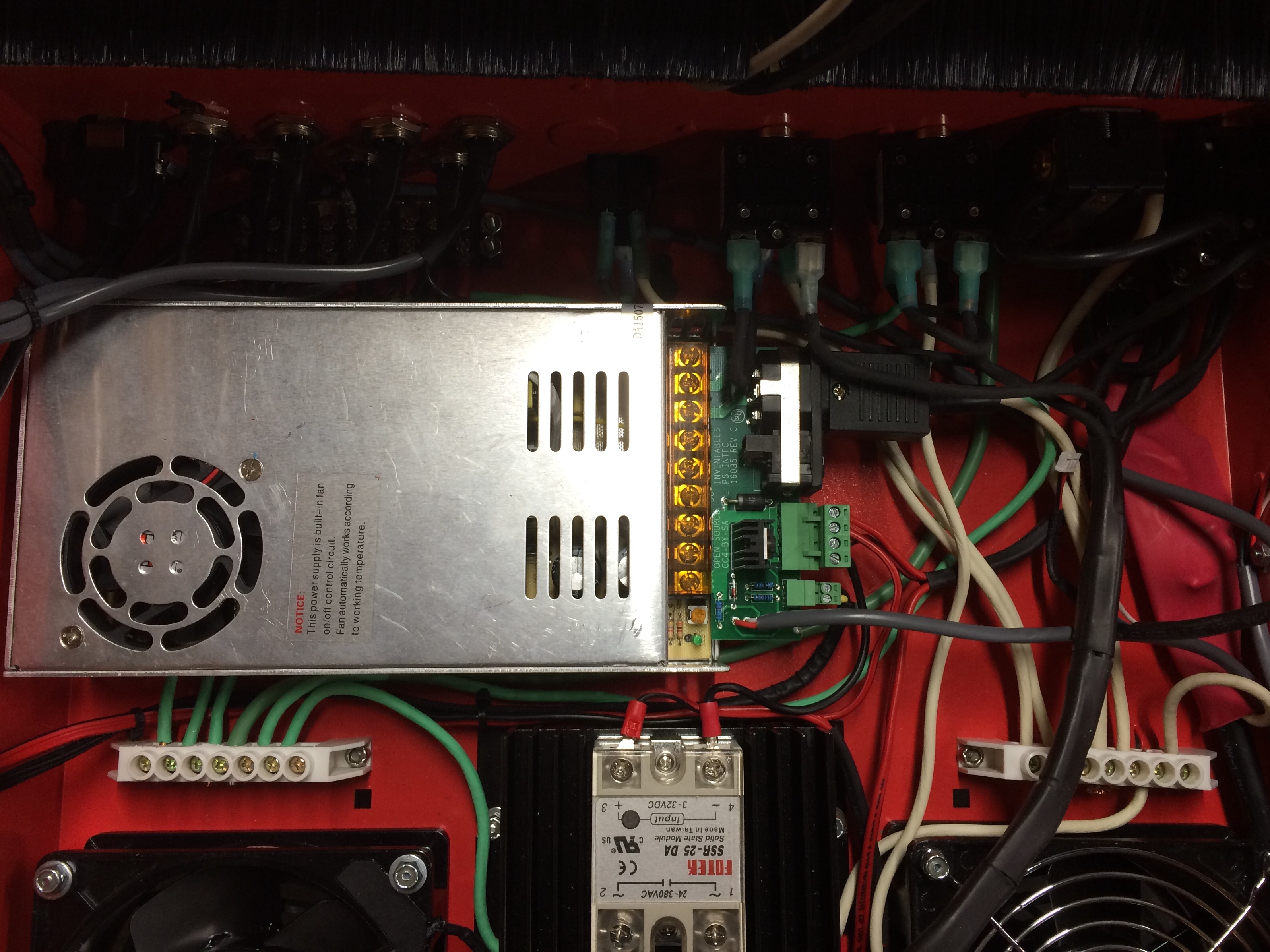

Power supply requirements then are 24V for a gshield based controller and 48V for the G540.
The G540 will certainly run with 24V but the steppers will have a slower top speed which could be more important on a bigger machine.
I agree with the building stuff, it’s more fun than using the end product.
Thank you. Just wanted to make sure that if I swapped out the g-shield with a gecko and upgraded the PSU, that the PSU unit will fit. The Gecko can be displaced by removing the XYZ terminal strips, since I can technically remove them and wire plug to plug. Still leaves me with plenty of room in the case.

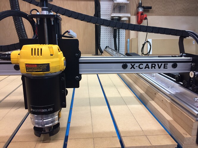

I have had good results using a throwaway clear plastic deli take out box as a dust shoe. The plastic is snappy, deforms and rebounds easily and is quite robust. It is very clear so you can see whats going on. I cut it with scissors up the sides at the conveniently spaced ridges to create “fingers”. When it runs into things it just deforms and rebounds. cut a round hole in the bottom (top now) the same size as the router and another one for the vacuum hose nozzle. It can slide up and down on the router shaft.

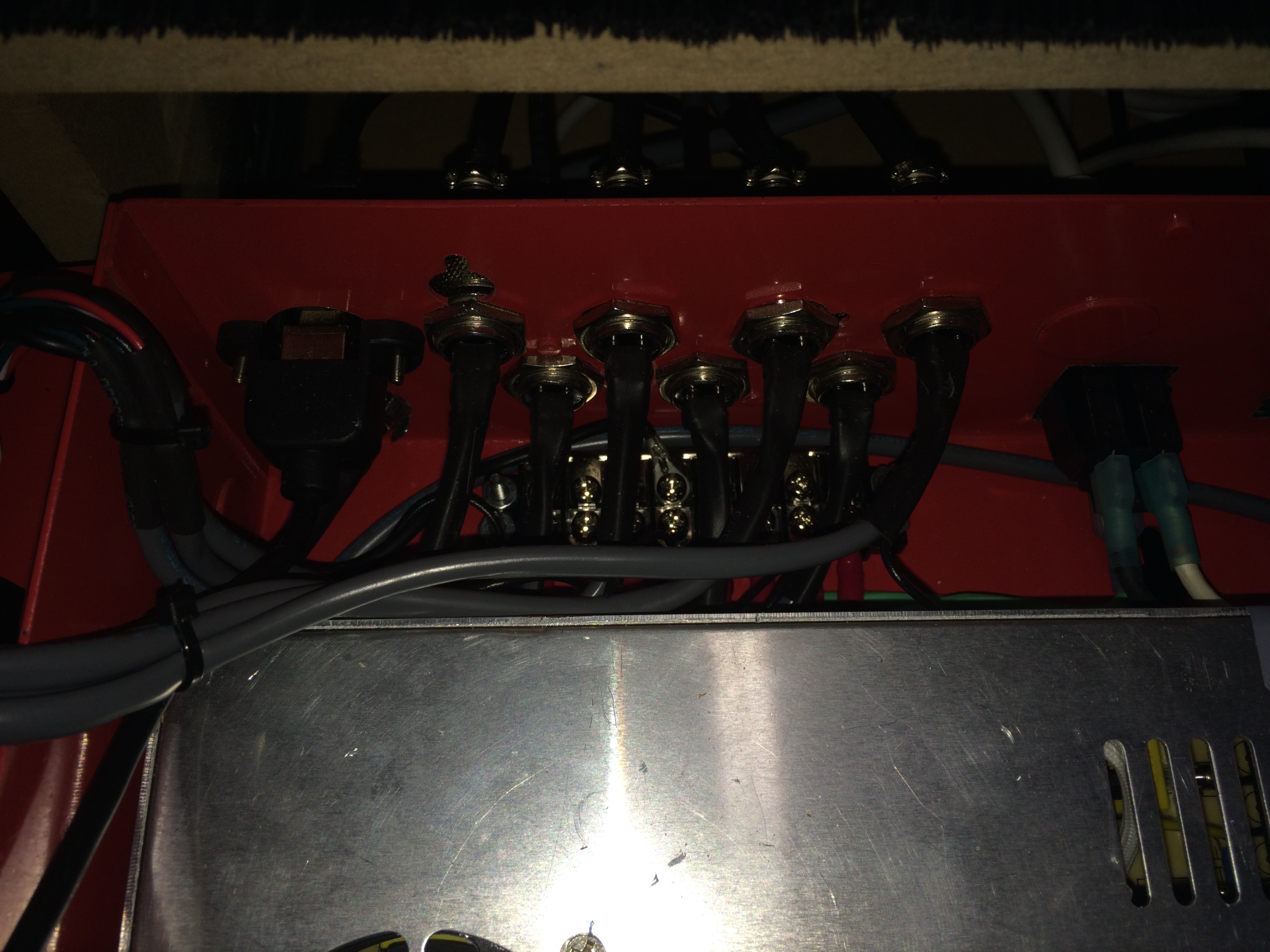

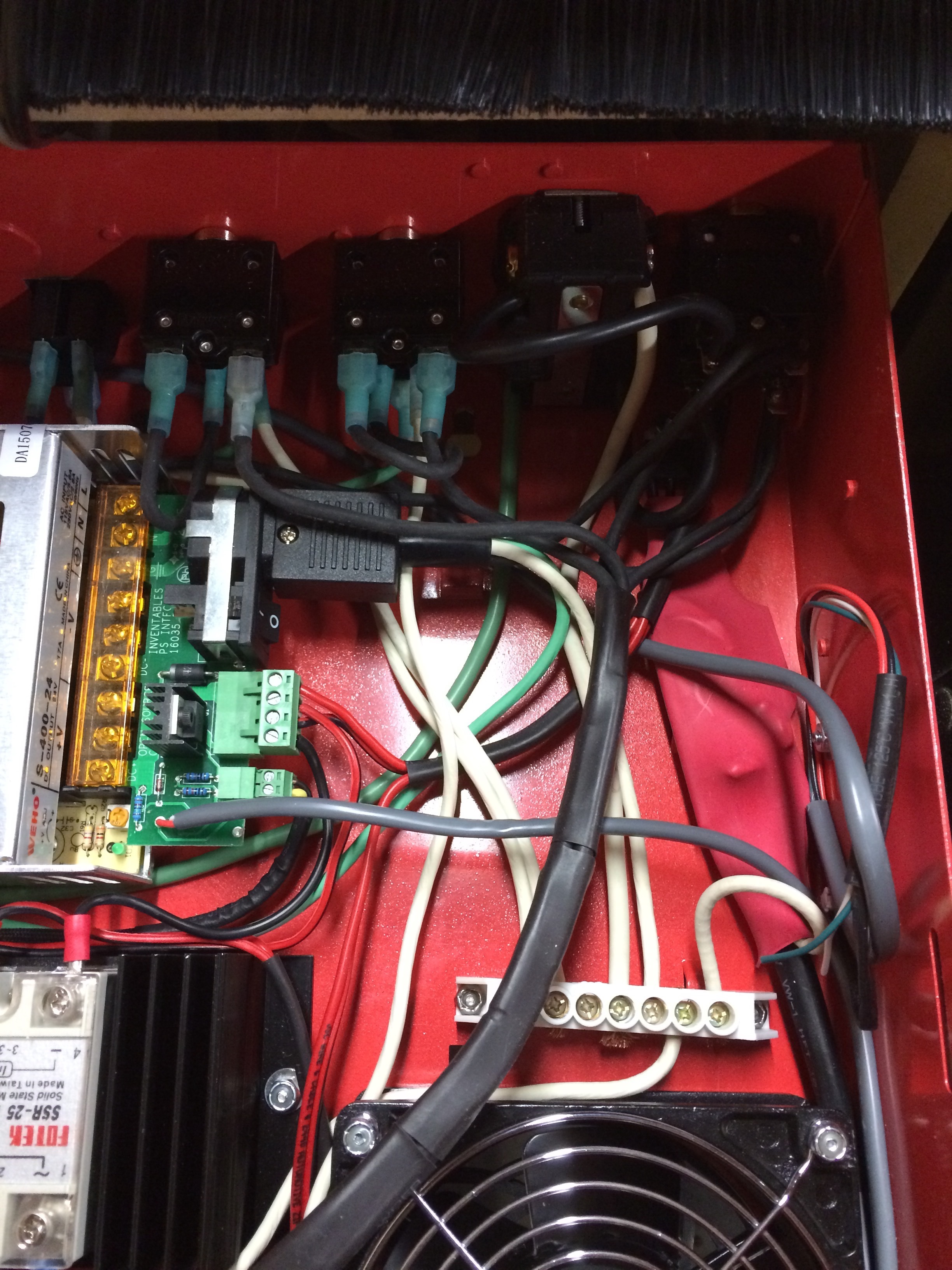

I have two Estops on my system. This ment that I had to buy 4 Estops to get the configuration that I wanted. I wanted to use 2-poles both supplying power until the button is pushed. The switches come with an open(NO) and a closed(NC) contact. Since I needed 2 of the same, I had two order double the amount of switches to swap out the poles on the backside.
Now I have 2 switches that don’t supply power until the button is pushed in. These will go into my tool chest for future use. They probably won’t do to good as an Estop switch since the plug has to be pulled out to stop the power supply. These will make good power buttons for something.
I have since stop using the dewalt ring to hold the deli carton in place. the plastic is so rigid and snappy it stays in place by catching on the grooves on the router shaft. this makes it semi adjust able on the fly and just snaps in and out of place.
