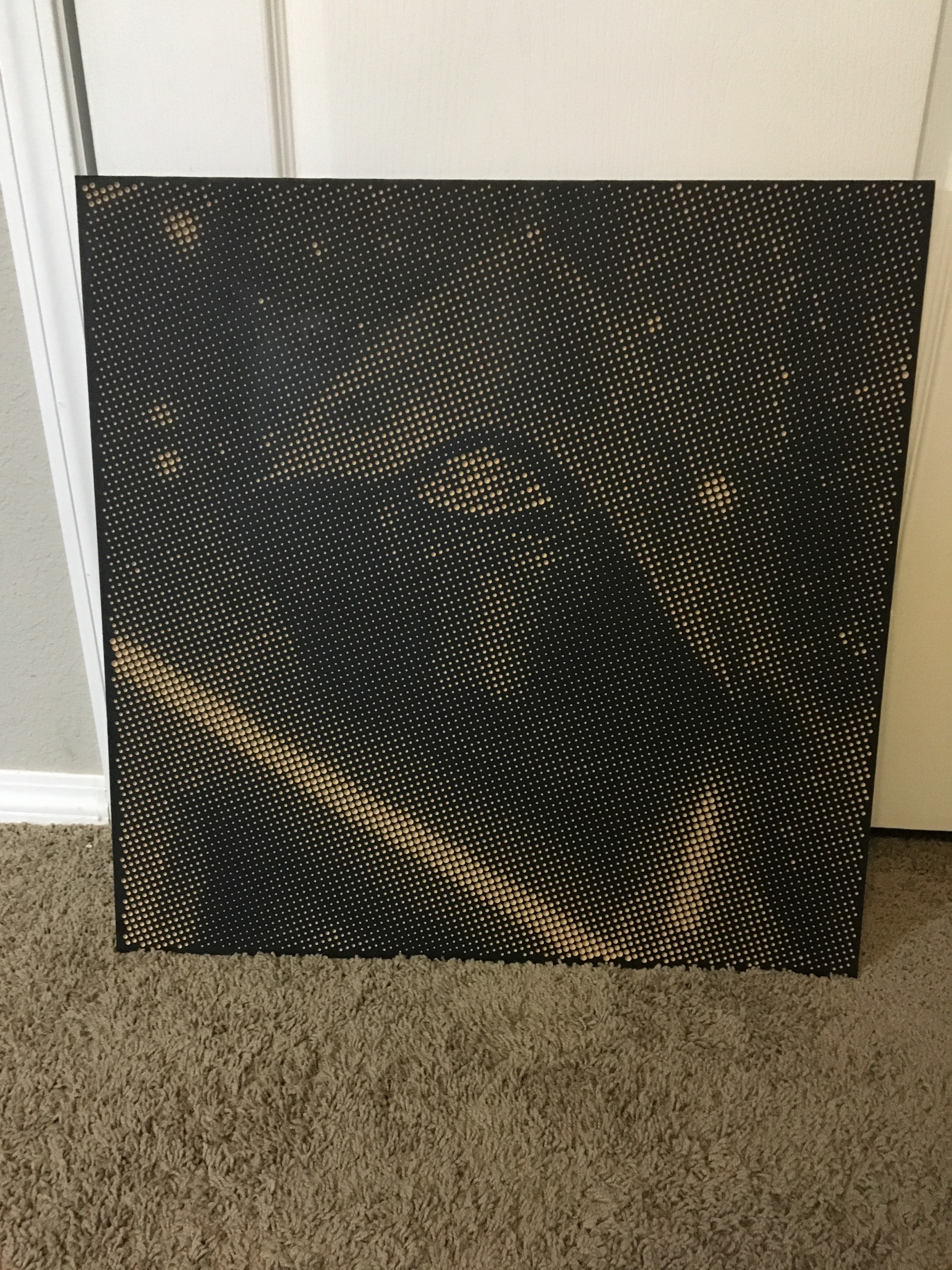

Here is the first of a 3 part set I’ve sold to a customer , Star Wars Villians.
Looks nice What are the settings your using?

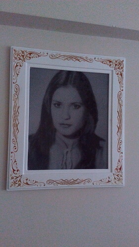

I have been struggling with lines. One of the variables I found is in using a painted board vs. Stain. Paint seems to act more as a glue on the surface and helps prevent unwanted chipping when doing lines. As far as settings, I found for lines, that using a spacing of 3, max width of 3.5, and then setting the brightness to -10, and contrast 16, gave good results. here is a 8x11 of a picture of Beyoncé that I did in about 30 minutes. I would suggest doing a google image seach for “gradient test” and use an image that transitions from black to white, and tune your settings using this image. On the white side, you want to ensure that it is just cutting right on the edge of and not deep. One of the things I am trying to do is find a good plywood that has a thick 1st veneer. The ones I find at Lowes seem to be less than 1/32 of an inch. Any suggestions?

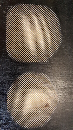

Here is my gradient test. they are 6inches by 6 inches on painted plywood. The goal was to get as much transition from dark to light as possible and make the center white as small as possible. These too about 5 minutes each to cut, so it is great for tuning the setting before you cut a picture.
Here is one I did in dots. I did not record my settings though. it a 19x 30 painted plywood.

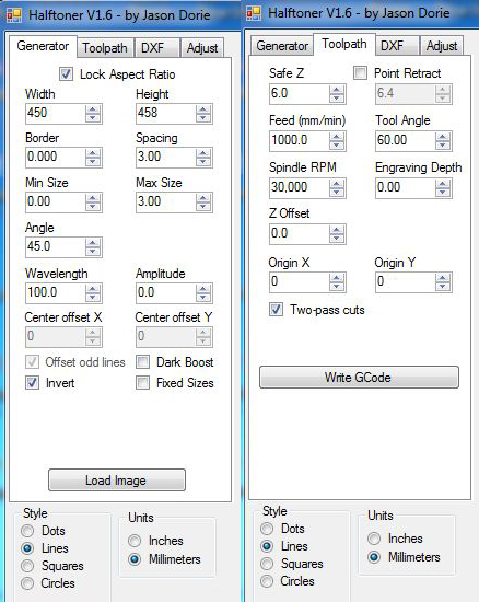

how to set spacing and max size? I have a bad cut if spacing and max size are the same or spacing is smaller than max size .
Spacing is how far apart the dots will be, and ‘Max Size’ is how big the largest dots will be. If you make them the same, it means the dots (or rows of lines) will touch. If that happens, fragile surface materials like paint mask or melamine will likely break off. For hard materials like anodized aluminum it’s ok to make them really close.
Max Size should not be bigger than spacing. I usually make Max Size about 10% to 20% smaller than spacing - for example, 3.3mm spacing, 3.0mm max size. If the result doesn’t leave enough surface material, you can leave the spacing, but reduce the Max size a little. ‘Dots’ mode is a little less sensitive to the spacing being too tight, because it leaves more material in general.
