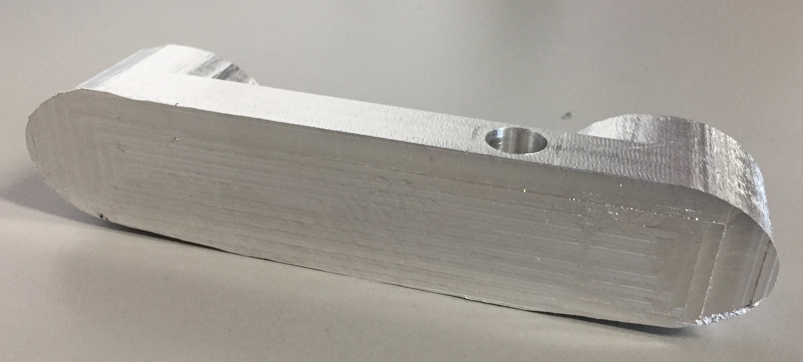

This was a two-step milling process. I started with a 1-1/2" x 1-1/4" bar of aluminum from here:
The putter head was designed using SketchUp. The .stl file was then imported into VCarve 8.5 to generate the toolpath gcode. I used this 1/8", 2-flute extra-long end mill (Search Results). Because the end mill was so long and relatively small diameter, I was conservative with the milling parameters. I ended up with these settings:
RPM - Dewalt setting 6
Feed rate - 30 IPM
Plunge rate - 15 IPM
Depth of Cut - 0.005"
Since the head was thinner than the aluminum bar I started with I had extra material to mill on the top and bottom. Once finished in the first direction, I turned the piece over and milled down to create the face. For this pass I used this 1/4" end mill (Search Results with the same milling parameters. The small chips flew out nicely during the process and I didn’t use any lubricant. The edges of the face still need some finishing. The hole for the shaft was drilled on a press between the two milling passes.
All in all, I’m pretty happy with the result. However, I’m not convinced the Z-Axis is perfectly vertical. I need to check that out. Any suggestions would be appreciated.
Personally, I prefer this look and it makes it easier to drill the hole in the head since it goes in vertically. I did drill the hole 1.5 degrees off vertical leaning forward which will effectively give me that much loft at address.
