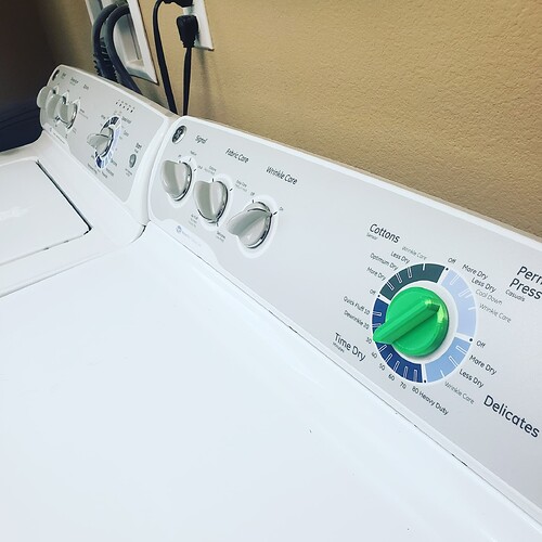

F360 hibbyist license (free requires annually attesting to the rules of use) will let you do this
… the free version really has not much for limitations. They reduce how many files you can actively edit at once because only a busyness would need to edit 10+ models at the exact same time… and they limit use of the 4+ axis machining and neuter the rapid moves to only move at the same speed as the feedrate setting… but nearly everything else that you get for paying you get in that hobbyist license.
So yeah if you model it it’ll let you exporr as a stl and 3d print no problem…
I modeled a replacement dryer timer knob in free f360, exported the stl and sliced with cura for example…
