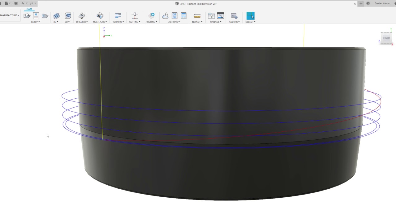

Below is a picture of my Microsoft Surface Dial’s Delrin Transport Case I made a few weeks ago:
Before cutting the chamfer, the vertical surface had a total length of 19mm which is close to 3x the diameter of the ONSRUD 52-080 ¼" 2F UpCut Endmill I used to do like 90% of the OPs on the shell.
In order to get this, IMHO, really nice finish I split that particular OP up into 4 parts:
Four 2.375mm cuts to half the 19mm full depth with 2 Multiple Finishing Passes of 0.66mm, Finish only at final Depth and 0.25mm Radial Stock to leave - So 4 cuts at 2.375mm each and the 5th cut at 9.5mm.
Two clearance cuts to half the depth with 1.5mm Radial Stock to leave.
Four additional 2.375mm cuts starting at half the 19mm full depth to full depth with 2 Multiple Finishing Passes of 0.66mm, Finish only at final Depth and 0.25mm Radial Stock to leave - Again 4 cuts at 2.375mm each and the 5th cut at 9.5mm.
One final cut at 19mm full depth with zero Radial Stock to leave but a Repeat Finishing Pass at 1/3 the feed rate.
Here’s a short Video visualizing it ( Step 2 Clearance Cut not shown ):
Alternatively, you could also model a channel and use an Adaptive Clearing OP to clear it out which would allow for cutting depths of 1½-2 Tool Diameters ( or more ) at once.
