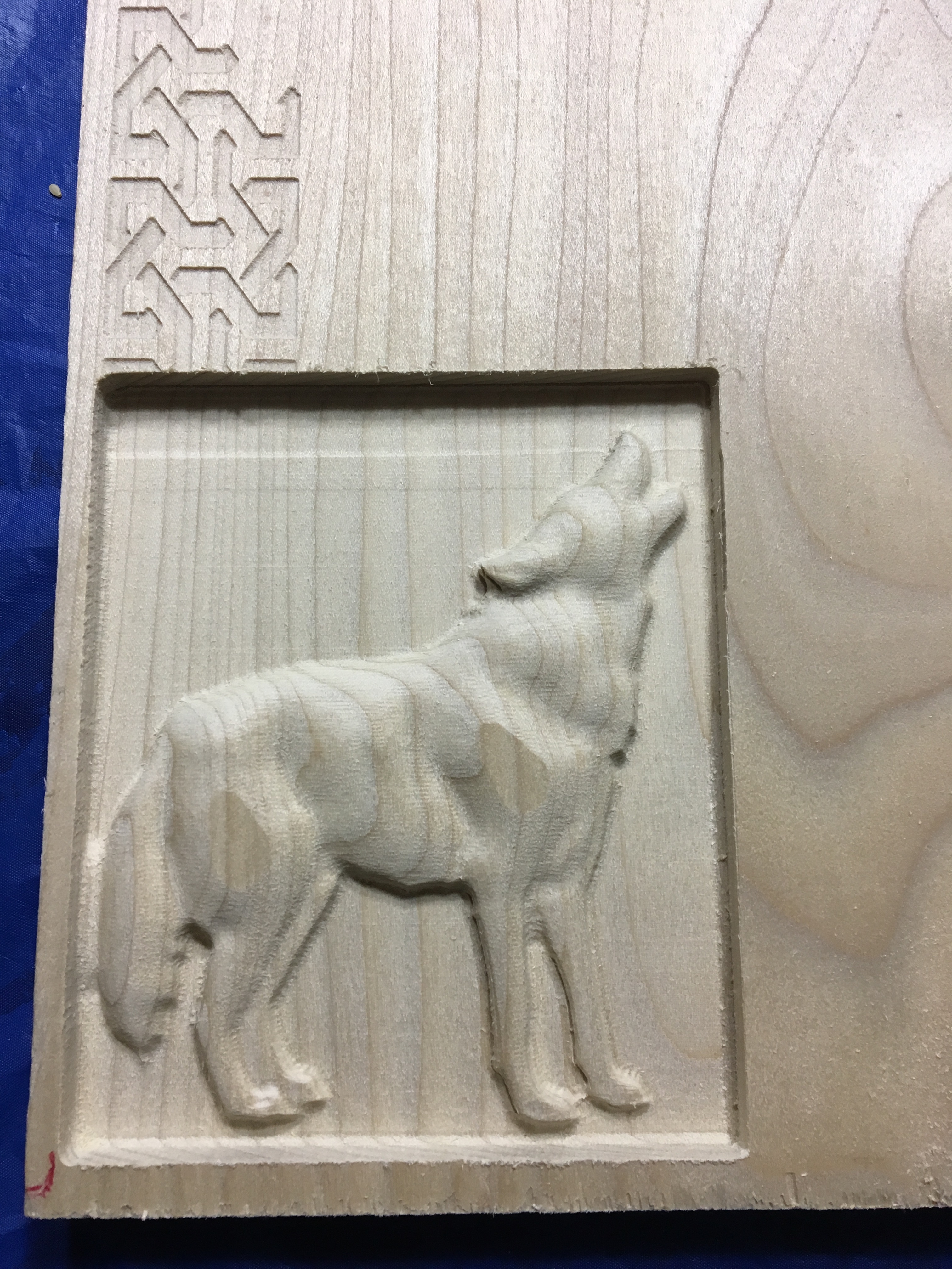

My 3D model had wrong cut
I start rough then do finish
i was having this exact same issue some time ago and would have been pulling my hair out if I didn’t keep it cut so short. . I contacted support, I was suspecting a software issue and Vectric got involved. it turned out i was losing steps when the z was RETRACTING ( going up).
I had been using a shop made disk with a handle on the nut on the top of the acme rod to manually move the z axis (slowly!) and I had slightly looseend the nut. This, along with my z pulley grub screws having backed out a bit was allowing the step loss. ditched the manual operating disk tightened the gub screws, added blue loc-tite and retightened the top nut, and all was corrected. Then I went to a linear z axis upgrade, but that is another story.
No only the finish did step lossing
Feed rate is 30 inch/sec
0.01step over
0.02 removing over
The acme rod did noises when go up, how to clean it and make it smoother
My acme rod started making noise when running up or down. even though it was very clean. I added some PTFE dry lube spray, available from home depot or most auto parts stores and it helped. My issue occured when in the finishing pass as well and looked identical to yours. Double check that the acme top nut is tight as well as the pulley grub screws. and try running it again.
How to use this spray , I had WD-40
He also may have tight delrin nut problem. Could you please go over breaking delrin with hand drill. I’m outside.
Alan refers to using a cordless drill to run the delrin nut up and down the acme screw 25-30 times to wear in the threads of the nut to the shaft .
Also, Wd-40 will only last a short time and will attract dust like a magnet and cause more problems for you in the future with possible gumming up of the lead screw threads. PTFE dry lube “spray” goes on in liquid form but thi is just a carrier solvent for the real lubricant, a form of specialized powdered plastic that if caution is not taken can create a bit of a mess. Before using it, you may want to clean the acme rod of any dusty residue with an old tooth brush and an air nozzle. hopefully the dust will have absorbed any oily residue that oy uwill be cleaning off before the PTFE is applied

Gotta jump in here…given that the line (defect) is horizontal and it’s on all the carves I’m going to offer that there is something with the Y rails that’s causing the issue. From the pictures shown it looks like the finish passes are being done on the Y (front to back) and produces the height difference in horizontally. I’d look for what’s causing the X axis to jump up, like a hiccup on the Y rails as it’s going front to back. Just another persons perspective.

When I change the bit from end milk to ball nose the zero not exact so the ball nose hit the edge of one side
I think this what caused the line on the top because I see strong hit after that the line appears

i understand now to calculate every thing in setting ,first of all i see how much the model high, then i sub 0.02 inch for finish then divide by 5 for rough.
my question is if i can reduce the finish setting to 0.002 inch because we do not need to take more from the service.
when I start roughing 5 times down in the surface ,it makes edge 0.25 inch ,when i start finishing, the bit hit the edge many times,I thinks with no adjust and calibrate the cnc will make this line.
