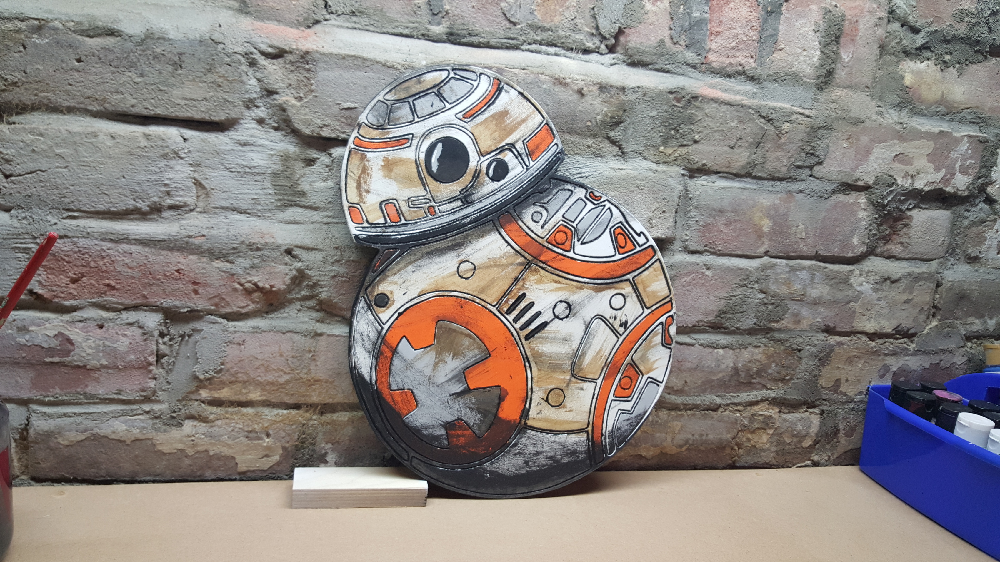

My BB-8 had a rough time on Jakku [Video]
Carved with easel using a V-Bit. 1/2" MDF primed and painted with Acrylic Craft Paints.

By any chance do ya have the pattern available for this? My cousin’s 9 year old son (named Harrison after Harrison Ford, huge star wars fans) just started chemo and thought it might be a great gift for him to look at from his bed, thought I would make a few different characters for his room.
If ya could point me in the right direction for the artwork that works also. So far the ones I have found aren’t as nice as the image you used.
I’m traveling right now for work but I got the files from thingiverse…it was designed to be 3d printed but it has great lines. I set it to carve the outline, on path, 45° v bit at a depth of about .03 I think. Test the depth to be sure. Acrylic paints is what I used to paint it. If you need anything else just message me. I’d say “Use the force” …but “that’s not how the force works!”
